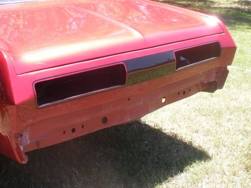

yeah electric trunk latch. I shaved my doors so I thought I could just add a solenoid to the trunk to but it’s not looking possible that way. I’ll look in to other model latches.
I welded over the hole in this car....

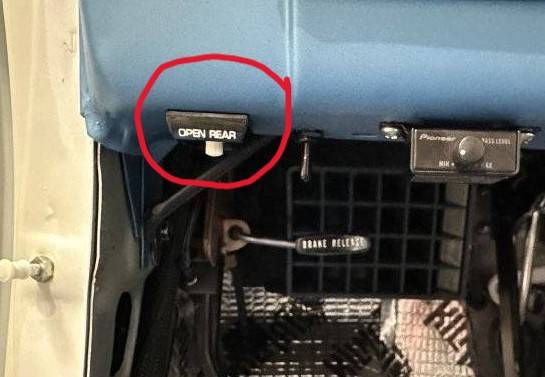

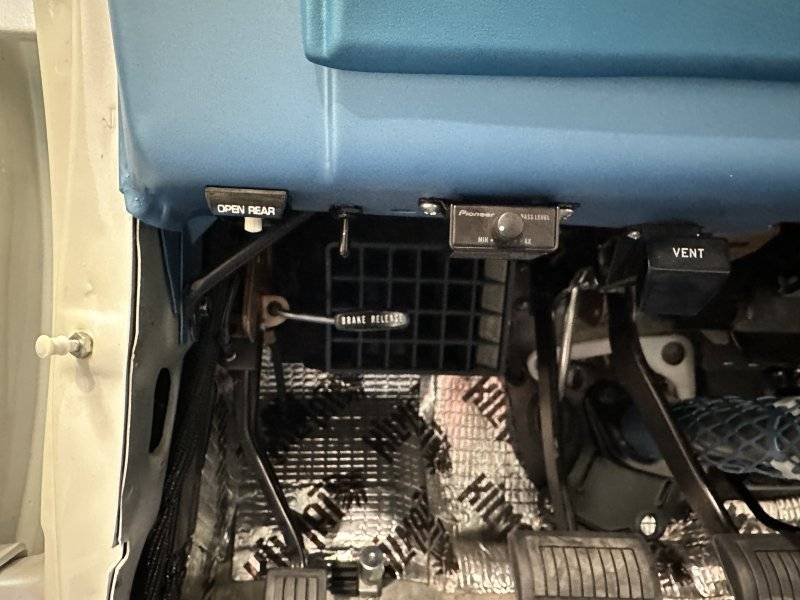

Uhhh....
Really? THIS is how you chose to label an electric trunk latch?
Come on, man....That HAS to be a joke!
