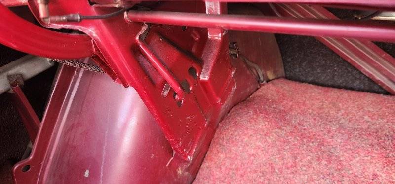

I can't find the pic of the hinge end but here's what it looks like from the middle. There's not really much that you can screw up installing these and have them even kinda work.
If both sides are in the first notch like in your picture, it gives you the most lift. I fumbled around with the torsion bars on my 65 Plymouth Sport Fury trying to get a little more lift but both bars are in the first notch and the lid only opens to about 2/3rds on it's own. I can lift it all the way but it really likes the 2/3rds open. I figure the torsion bars have lost some of their torque abilities. Probably the same issue you have.
On my 67 500, both sides are in the first notch, and the trunk lid stays open.
