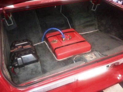

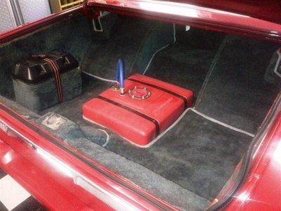

Here is one of mine..
and from the otherside

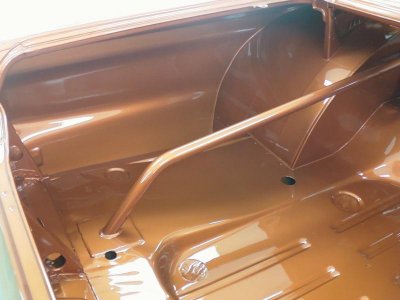

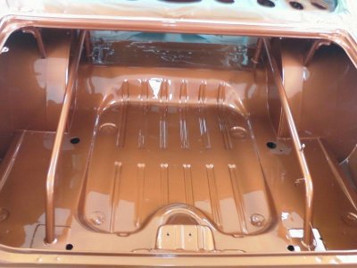

Why cover it? Break out the sander and the paint. I have to admit I did have to body work the inner 1/4s after my rust repair.

Furyous - thanks for the pictures. That looks really nice. This is about what I am working towards for mine. Now for the details :) Do your side panels fit into the outer ridge (hard to see)? How did you fix the bottom of the panels to the floor? Is the carpet on the wheel wells stitched together where the front meets the circumfrence or just butted? How did you fasten the carpet to the ribs on the rear section covering the light sockets?
Also, what did you do around the hinges? It appears to be a separate carpet "box"? Do you have a close up of that area? I have not been able to come up with anything for the hinges.
DVW - man if my trunk were that clean I surely would not cover it - but alas, it's not and covering what I have will be a whole lot easier than getting it to what you have there... That is really nice!!!
