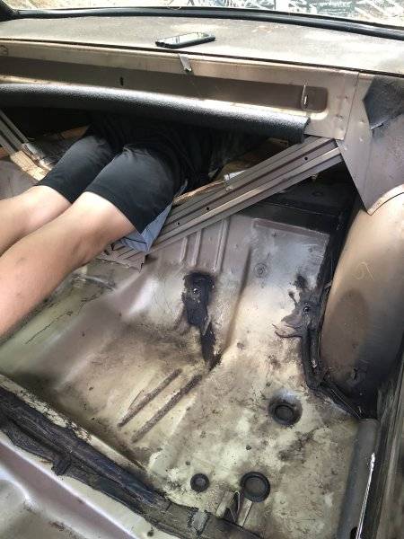

Insert the key, lock (cylinder) turns as normal but won't "pop" the trunk open...any tips on what to do other than take out rear seat and go in thru the trunk with ratchet and lots of extensions?

Yeah… don’t start ripping out interior. Do the smacking and wiggling first as mentioned above. I’d drill the lock out before I ever removed seats for trunk access.
We always pulled the seats. Easy 2 minute job. Then we used a broom handle with a slotted screw driver attached and slid that into the latch and gave it a turn. 10 minute job total. Took me longer to type this than to do the job. [lol]
Thanks, I'll try this next.
I tried this and it worked fine, a real piece of cake ! Thnks so much for the tip !
