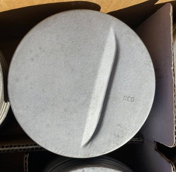

I have an opportunity to pick up a set of TRW 2295s on the cheap...
Are these still relevent in a modern std stroke 440 build?
Strong. Heavy. Better choices out there, but you know that.
Cheap? I'd run em. But maybe mill the dome off for a 75cc head, and consider tool steel pins to get rid of those monstrously heavy trw pins.

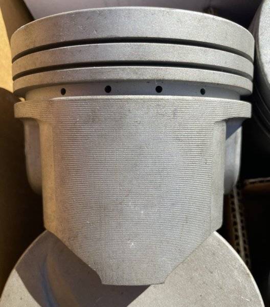

We run them yet...mainly because have them. We deck the block about .045-.050 to get them to zero deck. They are a odd height because they copied the ch of a 68-69 440hp piston and stuck a dome on it. After you machine the block to do 0 deck it limits future piston choices. I've seen 3 different 2295 piston styles. The early ones have stock style wrist pins and a narrow snap ring for free floating pins. Next they used a stronger pin that is tapered internally and changed the snap rings to a odd wide width. Both those piston are better off with a pressed in pin then free floating. The final rendition is under the Speed pro brand. They narrowed the wrist piston to lighten it about 30 grams and went to round c clip which is superior. Ours have had deeper valve reliefs cut for valve clearance. If you plan to to do old TRW 2295s and free floating rods you need to pass. At least they have the narrower 1/16 rings.

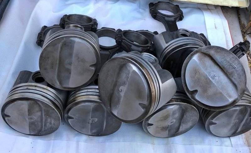

Looks like the pistons have Ly rods hung on them, 2295s will be fairly close to stock bob weights for balancing. The pistons are lighter then stock, but the wrist pin is heavier. Ours had some more weight added when it was balanced. The stock eyebrows are good for about .580ish lift. We cut ours deeper for .650 lift. The Ly rods and heavy 2295s will work over the block over time. We had lots of chaffing from cap walk...but we did hundreds of passes running in the 10s shifting at 6500. Had it to 8300 and stayed together.Lol
We have one engine w 2295s and eagle rods w free floating pins. Crank had lots of holes drilled to balance, it was a pain finding wrist pin retainers for the old trw pistons though.
There's nothing wrong with them, but we've found that around 7000+ they start pulling the pressed pins out of the rod.. 6500 should be fine
I had a brand new set that my buddy had the pins shrunk on back in the 70's with stock rods.
I put them in my 0.030 over 440 with Eagle rods. Bushed small end and I cut the domes down
so I wouldn't have 11:1 Compression. Dome height was 0.140 when I started and took them
down to 0.080. I used clip retainers for those big heavy pins. They're good pistons, just little
on the heavy side.
For the wide groove we used 2 spiral locks, or you could go back to pressed pins, and not worry about finding what fits.
I think that era of piston has the fancy pin that is machined on the inside. Heavy but strong. Probably made in the early 90s.
They are..the pins push right out...either direction. There are no locks currently installed
Ah ok thanks. Going back full circle, do the rods have pin bushings in them.
Stock pins were shrunk into the rods. These pistons are floaters so you can use them either way.
Eagle and other brand rods usually have bushings in the small end.
