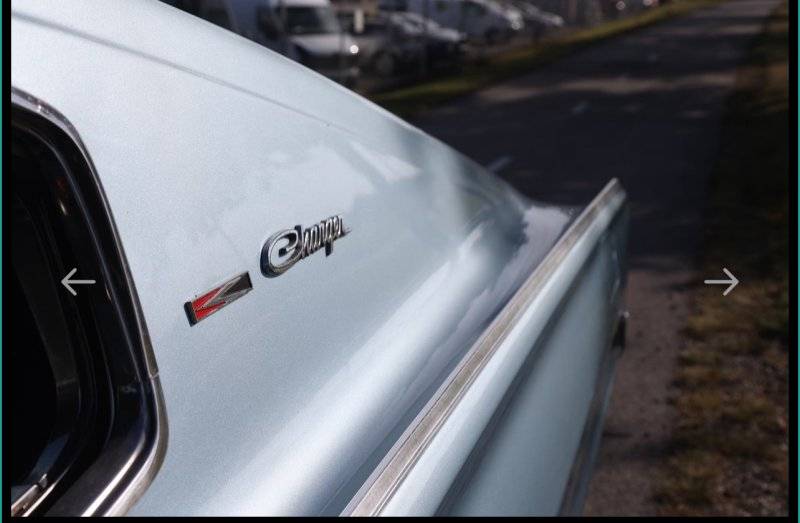

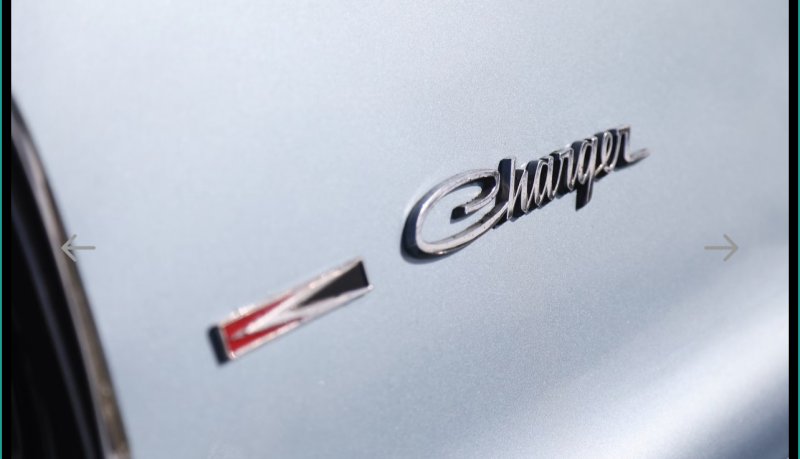

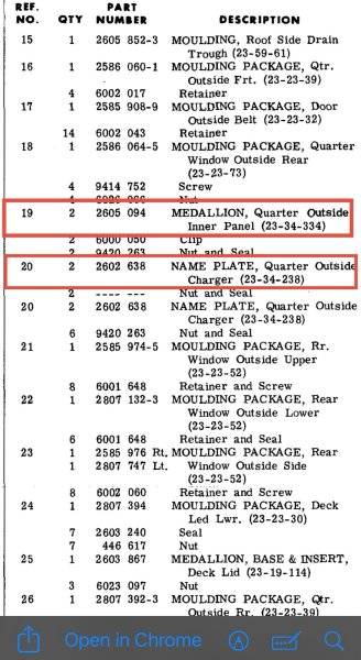

Trying to locate the right size Charger and Arrow emblem that go on the upper quarter sides of my 1966 Dodge Charger. Anyone know the part numbers?

So whenever this cat was repainted last. Someone took these emblems off, filled the holes and then never put them back on. Trying to locate the correct reproduction parts to put back on. I can’t seem to find what size of part number for both parts might be and wasn’t sure if any Charger or Arrow emblem from that time frame would work or be correct.
I should be able to look at mine tomorrow. For location, you can carefully remove the sail panel and hind the original pin hole location for both.
I believe the 68 Charger script will work but only has two pins. I would strongly suggest using double sided tape. Just knock off the pins. Check with some of the suppliers. DMT is close to you possibly.
Look up the vendors on this site.
