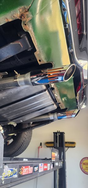

I got the tips with the kit for my 71 RR. They look great even after 10 years. Can't believe it's been that long since I installed that exhaust. Time flys
