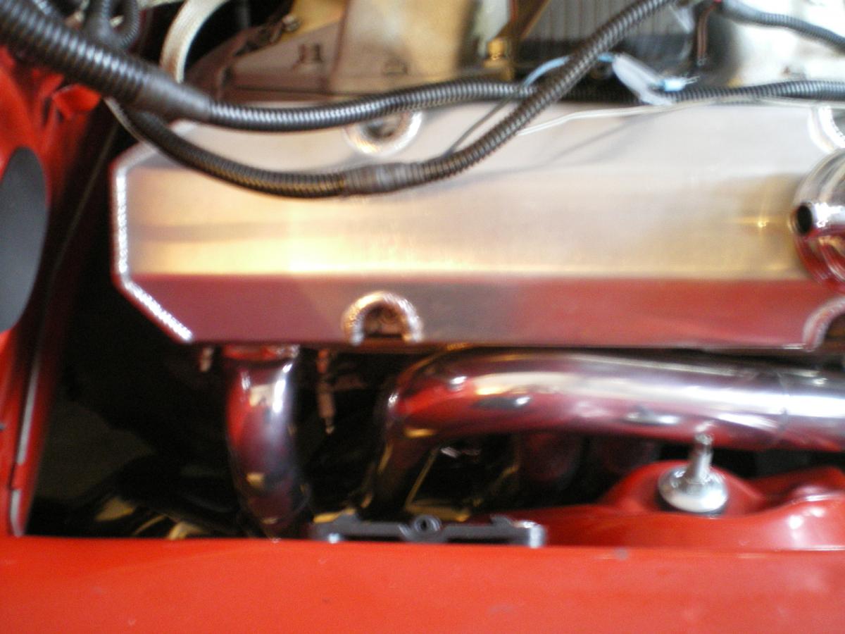

I run TTi 2 1/4 on my 62 and they fit like a dream I didnt even need a BFH. That big of a header makes it a little tough to get the plugs in on the passenger side but oh well.yea there expensive but you get what you pay for these days. dont just look at the cost look at the metal used ,coating used and the thick flanges with very nice welding on the gasket side. my two cents worth!:tied up:

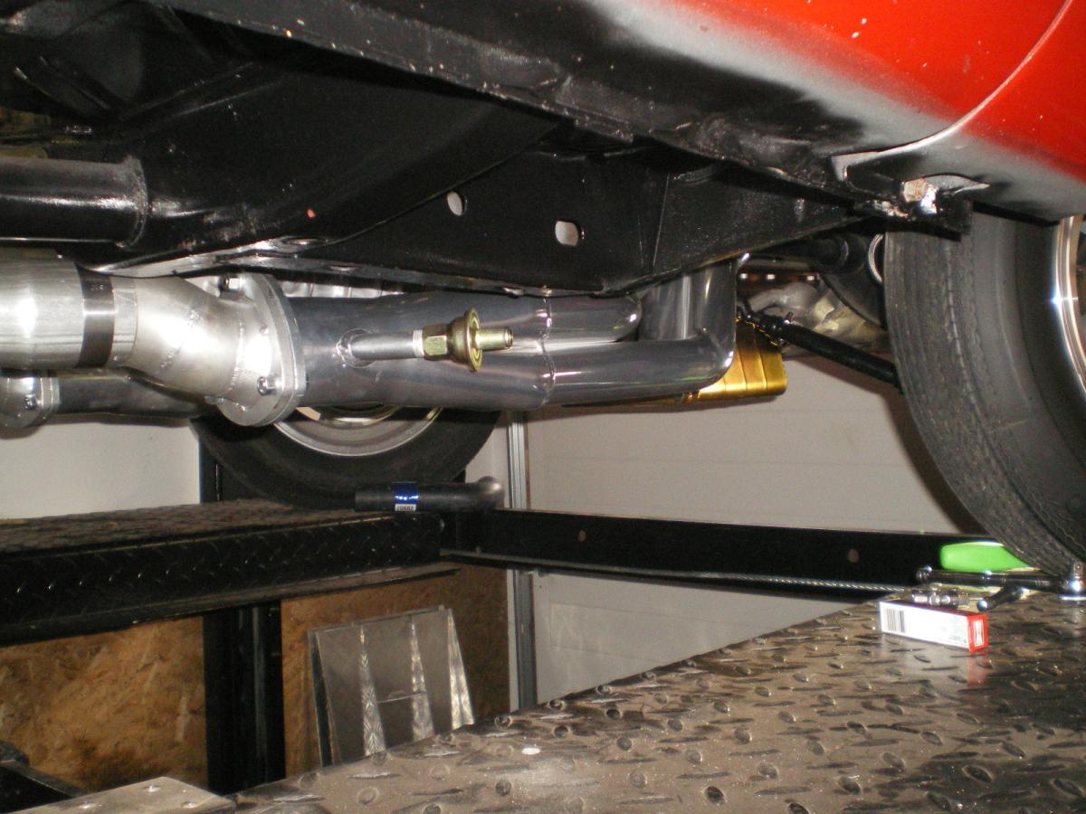

I had Hedman 1-3/4 headers on my old 440 and now I have 2" TTI's on my new eng. This is in my 63 Plymouth. The plugs were about the same to get at with both headers. I will say even though the TTI's are a bigger tube they fit better and were just as easy to get the plugs out. The only tight one for me is #6 but it really is not that bad. I just make sure I only change them when the eng is cold. Here are the TTI's. Ron

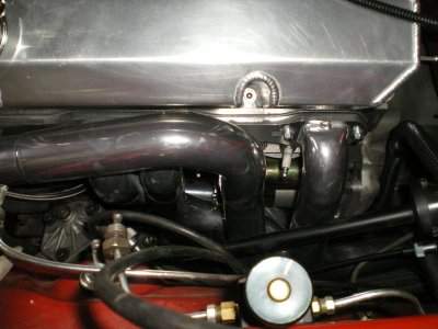

And these are the Hedmans. Ron
