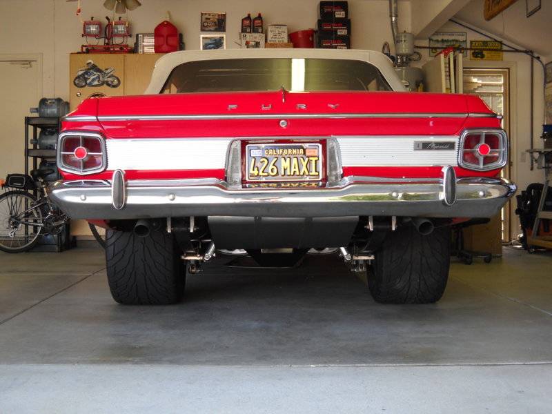

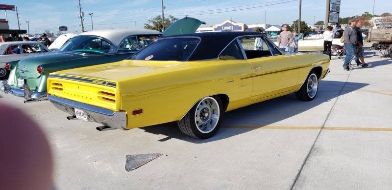

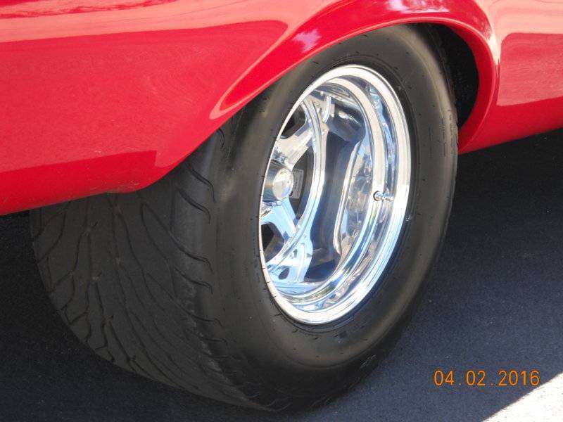

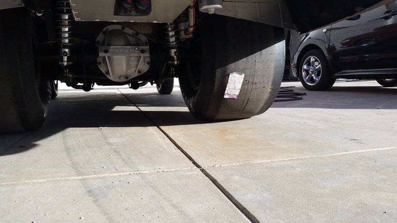

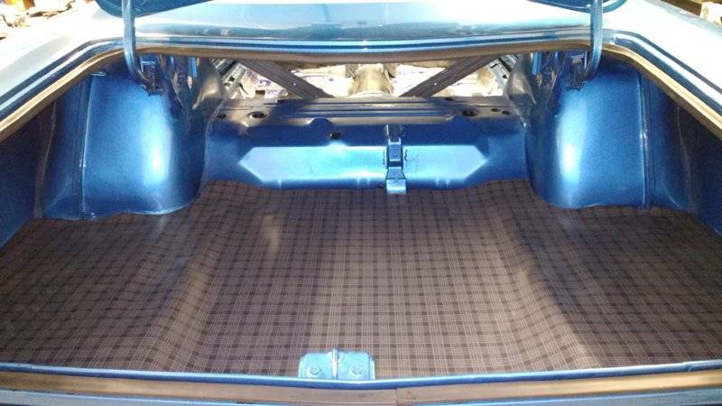

THAT is a VERY NICE look!!Mini tubbed to frame, Calvert Mono Springs moved in 3". 15"x12" Billet Specialties Street Lite wheels w/ 5.5" back spacing. 29"x15.0R15LT M/T Sportsman S/R tires (15" section width - 13" tread width)
View attachment 909082 View attachment 909083 View attachment 909084 View attachment 909085

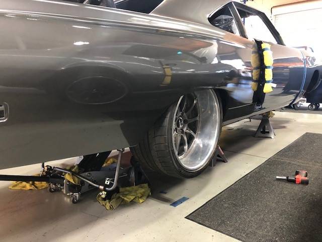

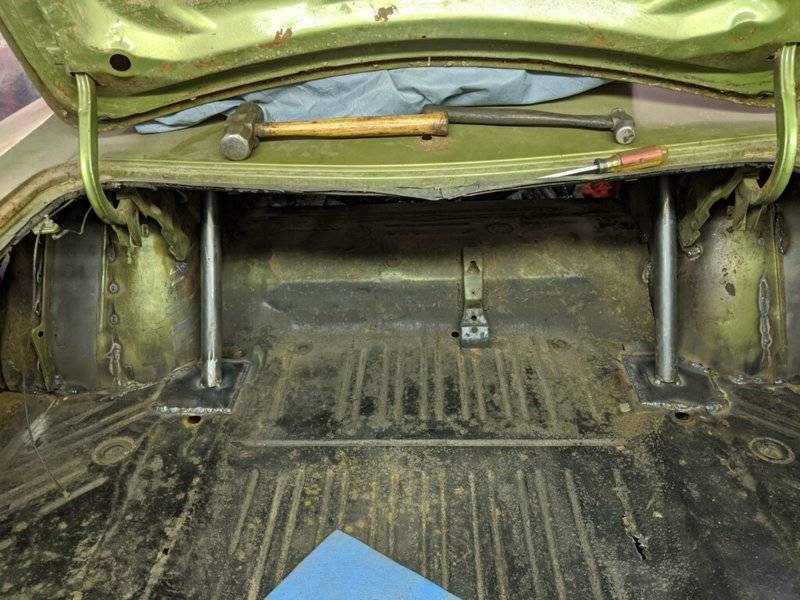

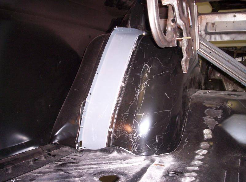

I like the minitub route. Like malex said it helps keep some of the structure in the back half of your car. And also you can keep the stock look in the trunk if you want. Also depends on the car how much wheelwell you need. A 66 Cornet needs more help than a 69RR.
View attachment 908778 View attachment 908779

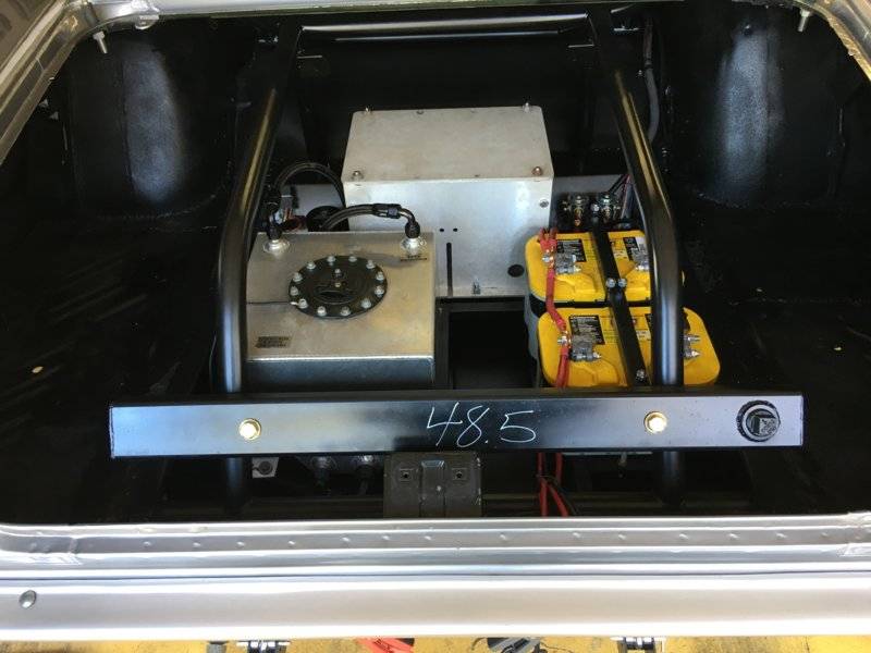

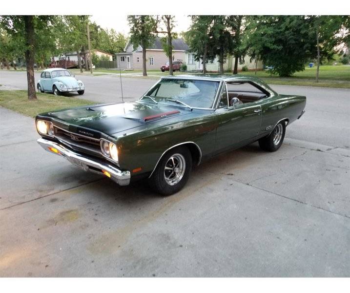

These are on my 69 GTX. One thing I didn't think about was the vent lines for the gas tank, you'll have to rebend or make new one to keep the oem look.

Man , that looks great, any pics of how you ran your exhaust? . I'm looking to run a stock location tank with springs inboard ,3" exhaust and mini tubbed also.Mini tubbed to frame, Calvert Mono Springs moved in 3". 15"x12" Billet Specialties Street Lite wheels w/ 5.5" back spacing. 29"x15.0R15LT M/T Sportsman S/R tires (15" section width - 13" tread width)
Wouldn't you like to visit South Louisiana this time of year? There's a number of warm, dry blue sky days...we could mini tub my Roadrunner!Heck I did a Duster along with moving the springs into the rails, metal finished in a weekend.

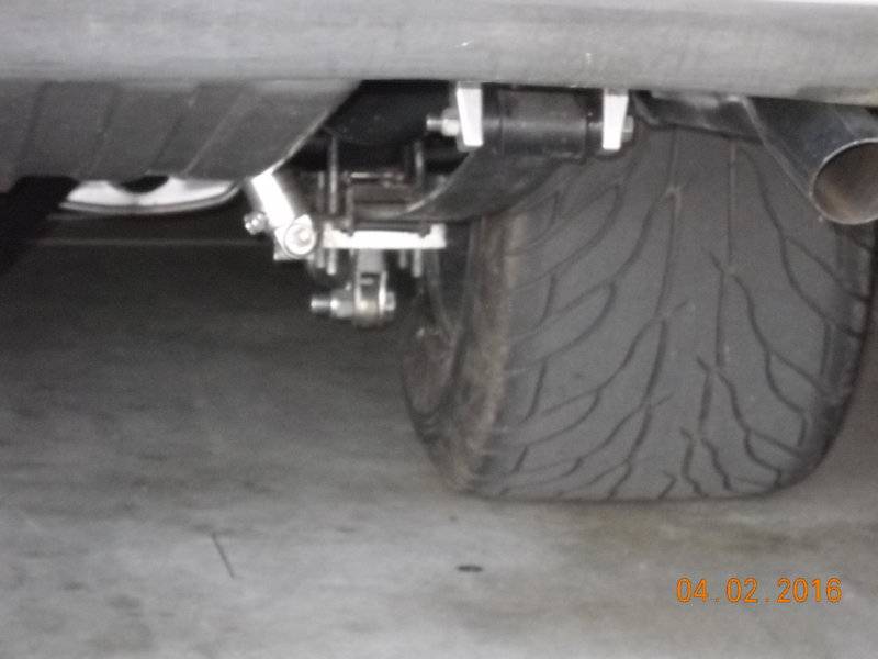

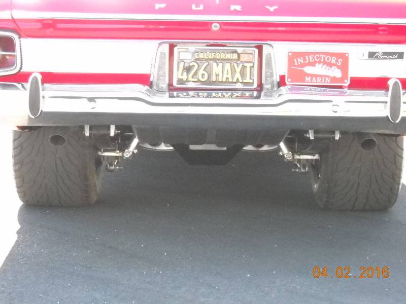

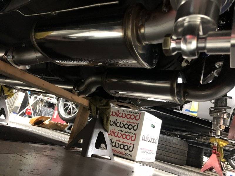

Nice set up, looks really good.Hi Dan, I have a fabbed Moser 8.75" rearend, just a little wider than the stock tank. 2.5" exhaust, mufflers stop just in front of the axle, go up and over and then bend outward, going through the opening between the frame and mono spring and then heading straight back. I was told it couldn't be done by a couple of muffler guys before one guy agreed to give it a shot. It's very tight but doesn't hit anywhere. 3" will be tough...View attachment 909367
