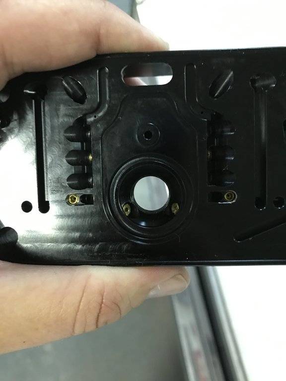

I am not sure what size bleeds are in it as it was put together 10 years ago by Don at FBO. I'll have to check. Transfer slots were set so that they were just a square showing below the plate. Since trying to figure out the tune they are open a tiny bit more than that. I try not to go past this point as you start to tip into the main circuit. That is usually where I can tune it to behave using the "idle" valve the demons have built in to the baseplate and proper idle screw adjustment coupled with playing with timing to find what it is looking for at idle. That just isn't working this time. Normally my vacuum is a little steadier and my timing more stable. Both are moving around a bit more than I have experienced when I was running the old solid cam before. Before timing was rock steady at 20° at idle and had a steady 15" of vacuum. I confirmed tonight no vacuum leaks, no header leaks, and I changed to some fresh plugs. All looked like they were firing but looked like it was running pig rich. Tomorrow I'll swap out for a new 3.5 PV to make sure I didn't grab a bad one from my box. Then I'm going to run it until hot, set the timing back to 20° and redo the lash to make sure I'm not too tight on any cylinder. I know I tend to like a firmer feeling lash adjustment than some of my friends so I could be a little tight. I am also going to put the transfer slot back to a prefect square and bring the fuel pressure back to 5.5 lbs. This should give me a better starting position to tune from.True kind of, (it changes when the enrichment of the mains begins) if the main circuit is in use. you shouldn't see anything coming out of the boosters at idle though. Idle and main circuit are separate and that's how they should be viewed. I run the 6.5 to help cover up the lean spot when my vacuum carbs open. I ran a 4.5 in my DP. Ive ran a 4.5 in the 6 pack and seen no change at idle when I went to 6.5 on the a/f meter

What size air bleeds do you have?
what's the ifr size?
Also you said t/s are equal, how much is exposed?
I don't know the bleed sizes but will check tomorrow. I think you and I are on the same page. I initially set the initial at 24 because that is where the motor seemed to want to be. As I added initial it kept speeding up until I hit 26 and then didn't anymore so I backed it back to 24 and set the distributor to throw 10. I downsized the 65 to a 25 as I had a few backfires through the carb so I wasn't sure the 65 was still good. Once I get everything sorted out I am sure my idle vacuum will be near 10" so I will go back to the 65.You don't have to pay any attention to me if I'm all screwed up. I would run a dead minimum of 20 degrees and 24 seems better to me.
Your carburetor tune really has me baffled. The 850 Mighty Demon comes with .070 idle air bleeds, .031 H.S. air bleeds, 6.5 power valve, #85 primary jets and #93 secondary jets. I've always found that the primary to secondary 6-8 jets size stagger is required when using a power valve. Maybe your carburetor has some super trick modifications to change the stagger that I've never seen before.
