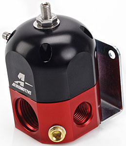

Here you go... you asked for a real mechanical "racing" fuel pump... Race Pump brand RPU-2000 for Big Block Mopars capable of 450gph @ 50psi, piston style race pump, almost any fuel capable, you will need A/N fittings hoses & a bypass style fuel regulator {or fuel log} & a by-pass hose back to the fuel tank... they aren't cheap @ $319.95, but are a real race pump, are extremely reliable, very little to ever go wrong, also are capable of almost any type fuel system you put on-top of you BB Mopar, short of Nitro Methane, they don't rob power at all, they don't wear out camshafts or the fuel eccentrics or actuation rods, either, they are far superior to any other "so called" mechanical race fuel pumps, other than a Waterman, Enderle or Hilborn Etc. or some other camshaft direct &/or belt driven style modular race fuel pump... Summit Racing has them in stock... I also recommend you get a quality fuel pressure gauge, to monitor what the fuel system is doing, although with this RPU-2000 pump you probably won't ever need to worry about it, after you set the fuel pressure initially... good luck racing isn't cheap if you want to do it right...

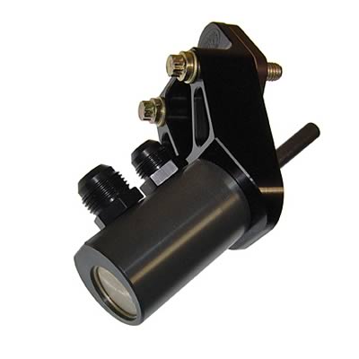

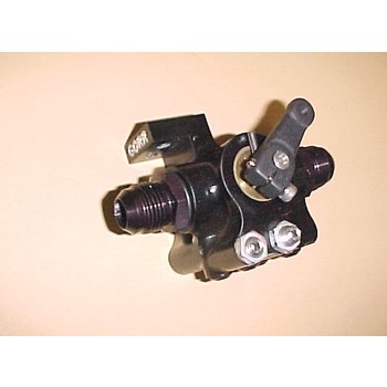

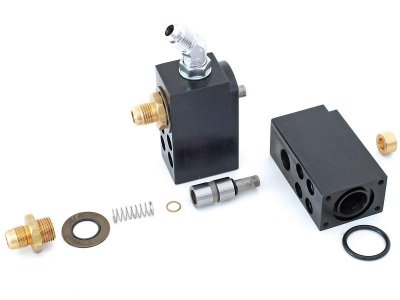

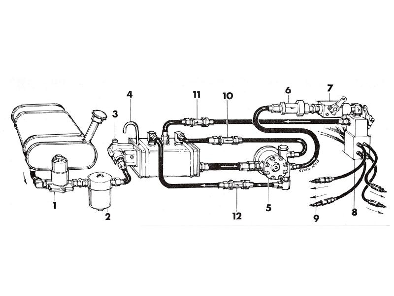

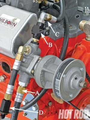

What type fuel will be used, Gas or Alcohol/Methanol ?? what type size nozzles & where are they ?? under the hat only, or do you have port nozzles too ??... Good choice with the hat instead, of carbs, but for gas even blown gas a Bug Catcher is plenty big enough even... Bird Catcher is for Big Alcohol Engines, but can still work, that's allot of air flow... The 80A-1 sounds like a Hilborn {A is for alcohol} part, Enderle Kinsler Hilborn Fowler Crower etc. all will use them, the style shape size spool/Barrel valve & bypasses & type of lines & distribution block & rate of flow/type of fuel % @ the barrel valve & bypassed off @ idle, will all determine allot of what will & won't work... do you have some sort of mechanical fuel shut-off valve cable & lever & bypass back to a cell ??, I hope so or it will just dup allot of fuel into the blower/manifold at ignition shut down... especially with a blown engine... Do you have a way to prime it for easy starts ?? or you just plan on cranking it tell you get fuel up there... remember you don't/won't have an accelerator pump any more... you can always prime it with a small squirt bottle of gas, before you get in to start it... Good Luck have fun...

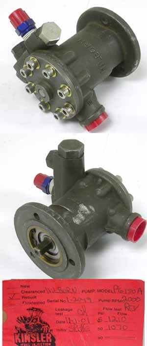

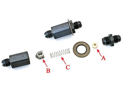

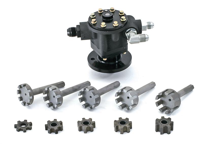

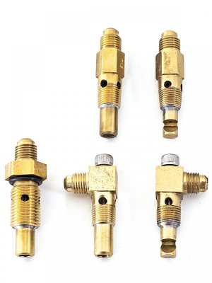

  • Fuel Injection Idle Bypass or Highspeed Bypass with plill & presure springs.jpg
  • Fuel Injection fed to forward resevoir Complete system Plumbing & parts.jpg
