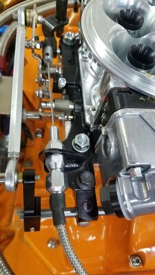

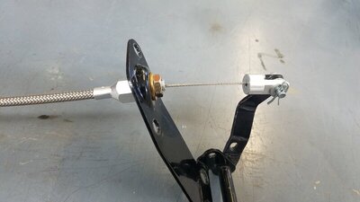

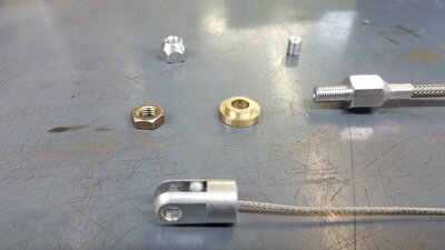

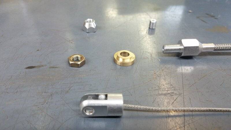

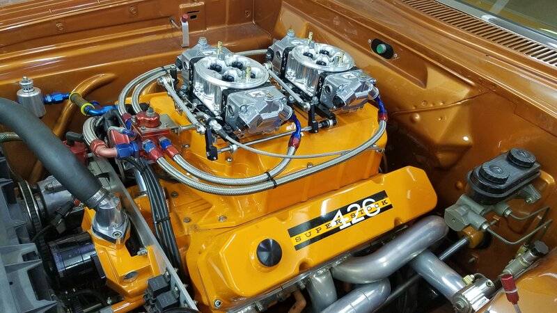

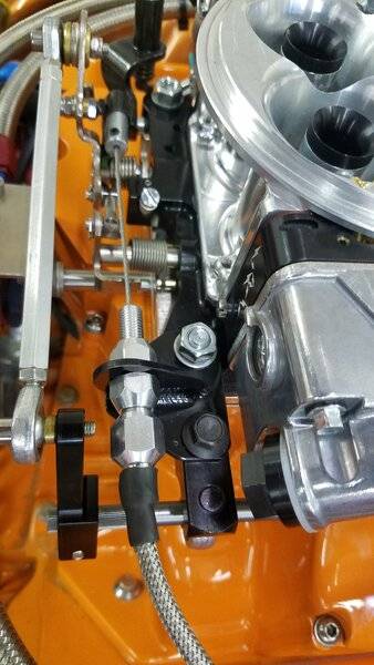

First but a $20 E-bay cable that makes it up to the carbs. No bell crank crap. Then if you don't run a manual valve body get a Lokar cable kit. This is different set up but shows how to get the cable to the carb.

20210308_175030.jpg 20210308_174433.jpg 20210227_110101.jpg 20210227_110904.jpg
