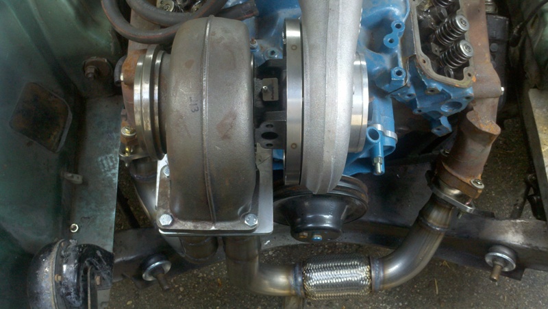

This is a picture of the beginning fab work. There is a Y right below the turbo. There is no need for an inter-cooler with a carb and E-85 for fuel. That's the ticket. Detonation is a non issue @20 psi.

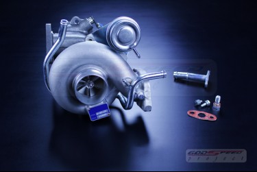

If you haven't bought the turbo yet look at intergated turbos then you won't have to add the cost of getting waste gates on top of the turbos they are built in.
Look like this the intergated type

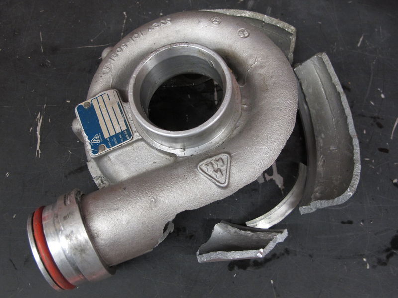

This is what happens when you cheap out:

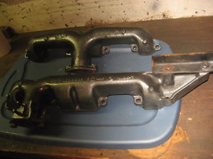

You guys are way to complicated. 1 turbo, 1 carb, no intercooler. At that low boost just run off the BOV spring. Get some low performance truck manifolds, turn them around backwards (left to right swap). Plumb it up blow through E-85. Minimal timing. spend money on a good e-85 blow thru carb and get a good fuel pump. Run 20-23 total timing at 10 psi and have fun.
