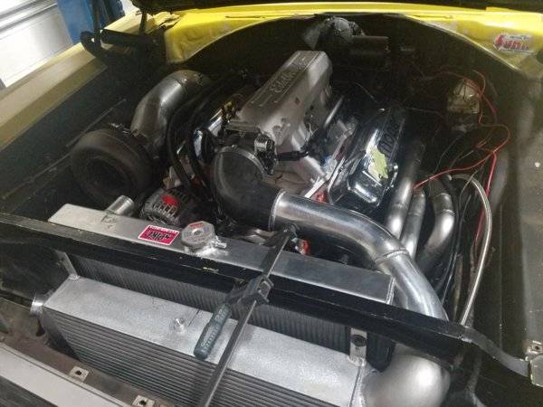

Very do-able in a home mechanic environment. I used mechanics tools,a mig welder, and a grinder essentially to twin turbo my 440, with a front mount intercooler.
I used a variety of 16 gauge aluminized tubing bends for the piping.
I regret not making the whole hot side from scratch, I incorporated some e-bay stainless headers and flipped them upside down as part of the hotside. If I did it again I would try to incorporate some stock cast iron exhaust manifods or buy some header flanges to start with. Also considered welding my wastegates to my turbines, but did not have a tig (I have never tig'd anyway) so decided not to, I should have just gone to a welding shop. Also, the oil feed lines to the turbos leaked, the hose could not handle the temp conduction through the oil fitting from the turbo, so I would recommend steel tubing to start with for your oil feed line(s). In my 74 clonerunner A hemi vacuum booster may have made it easier to fit my drivers side 3" downpipe as well.
It works well as it is, but I plan in the future to re -do the hot-side sometime, with the Wastegate attached to the turbines and then dumping right into the downpipe, It will make everything so much simpler, and look cleaner.

lol thanks. I got the bug for wagons early and bought that car when I was 13. Didn't do much to it for years and just got this setup together a few months ago.
