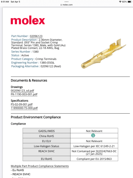

Does anyone have a source for the bullet connectors to rebuild the ignition switch and turn signal plugs?
Thanks
I got some from Mouser.
https://www.mouser.com/?srsltid=AfmBOorU7oZpBye4IIO9rqXwkNB-ku3YJDuiLSsiyAj2S58kIQNIRhCr
I use digikey to track down my latest hard to find terminals.
Their catalog is massive, so have some measurements of the terminals you are looking so you can narrow your search.
Chances are they carry thr exact part labeled above, use the part number to search .
May want to consider a better connector for the ignition switch, something that will actually handle the current loads at that disconnect.
I may go with the anderson power pole. I'm running a painful wiring harness so originality is not really a concern.
