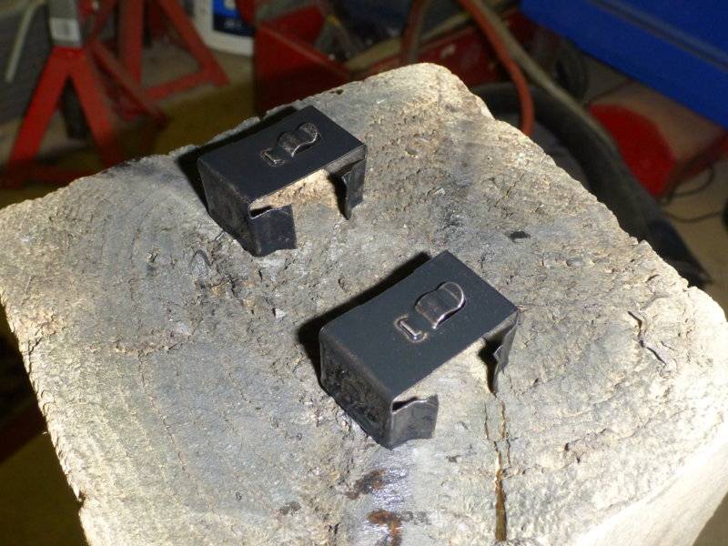

under dash next to left side of ashtray . pull ashtray and unscrew frame if all else fails,right there on left..
As Justin wisely points out, listen for it to find.. and it should be in a clip to the dash frame.
