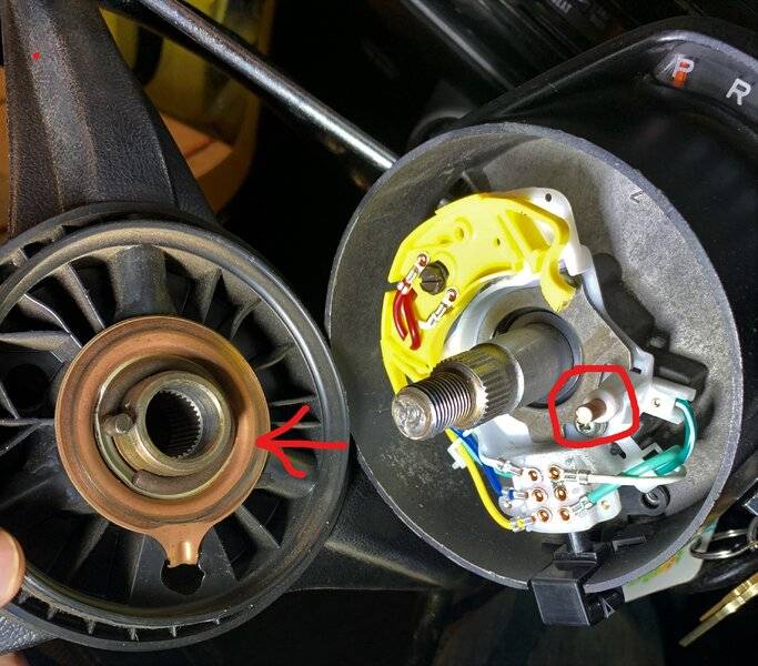

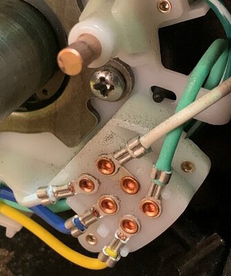

So, I am replacing my 2nd switch in 2 years with these cheap repros. I noticed before and now that my steering wheel starts making a scratchy noise after a while. I thought I would investigate closely and what is going on is the spring loaded brass looking button scraping on the inner brass looking thing behind the steering wheel. This is the button that makes the electrical contact for the horn.
The old factory one never did this. Look at pics and see even where there are fine metal shavings building up in there. I wonder if that's what makes these things fail?
Any suggestions to correct?

The originals had a wheel that rode on the brass ring.
Doing that on the repros would have cut into the profit margin, we can't have that.
I was thinking about that, but dielectric grease is non-conductive. I want to make sure sure the horn keeps working.

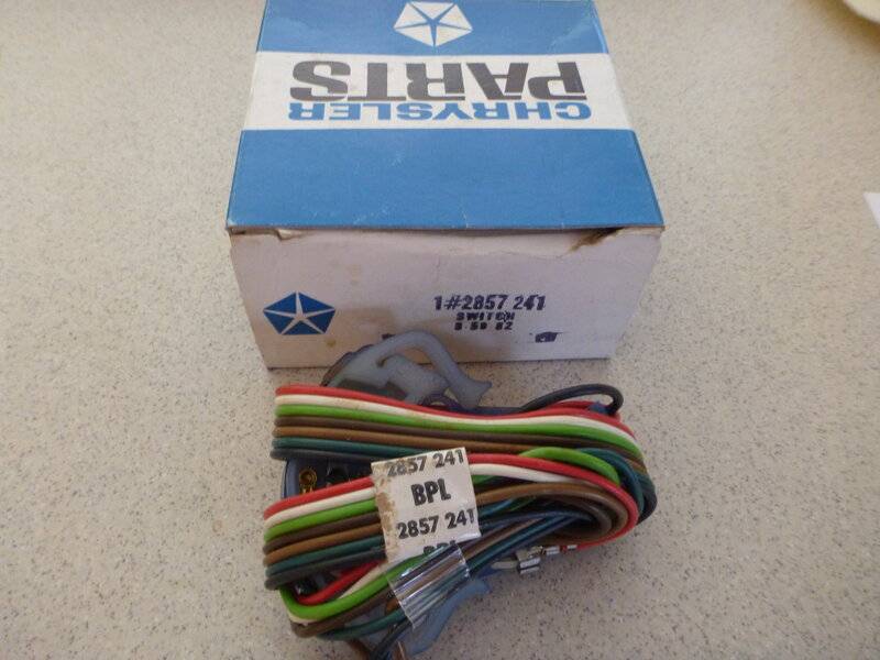

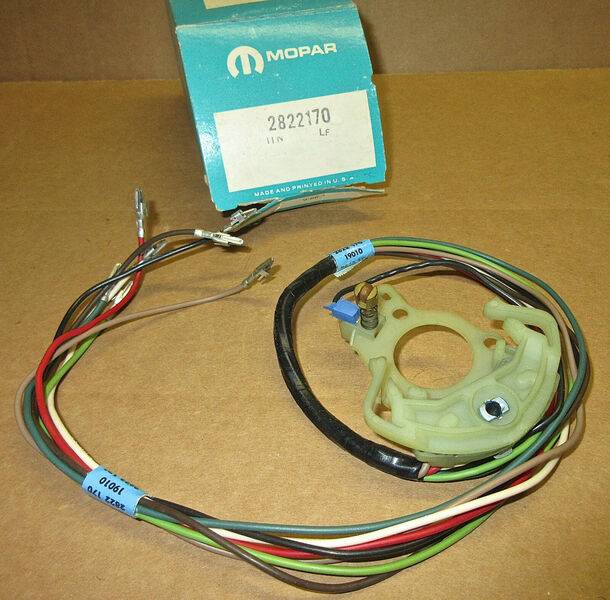

I bought one from Year One, pretty sure mine had the wheel, think they even offered a cheaper one? Can't even remember when I put mine back on the road but I know it's lasted 5 years, of coarse that's in Ohio where you only drive them half of the year.

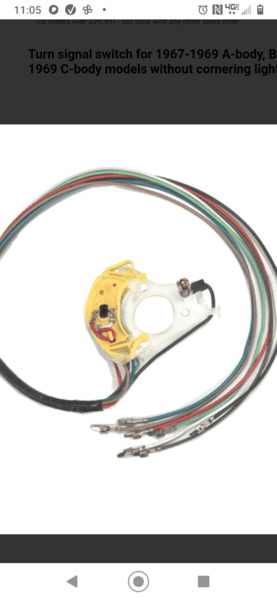

I found this on their site, must be the one I bought?

Well, I couldn't really find one for a 72 that had the wheel. I ended up putting a fairly liberal amount of white lithium grease on the ring surface. So far, so good. Nice, smooth and quiet now and the horn still works fine. Don't know how long it will last this time, but we'll see. The first symptom of these failing for me is that the brake lights stop working, or the 4 way flashers in the rear. I'm in the habit now of periodically testing those rear lights by turning on the flashers so I know they are working. Brake light failures without you knowing is a safety hazard. Both times the switch failed, I only knew because some driver behind me told me.
