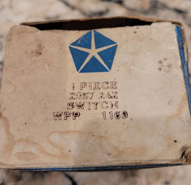

good evening, i need a turn signal switch for my 69 Charger. I have heard that some of the switches available have some issues and need some work. Was wondering what brand to buy, or who to buy from? Thanks

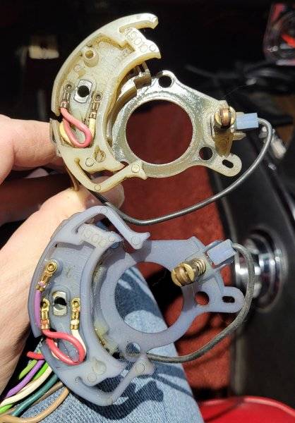

I just replaced one and went through this discussion. Buy NOS. The one that was defective was Chinese crap. Only lasted a few years. All the auto parts stores switches are Chinese crap. Put a post in WTB on this board or shop eBay.
NOS is the best bet by far. Only downside to them is how much they cost.
i payed 300 for mine in mopar package and dated for 69 happy to get one as fire is not a good thing.

I have used Dan's switches as well. If you don't want to spend the $ on a NOS, his are the next best option by far. The only thing I don't care for with them is that the lane change feature is not built into them like oem 1969 and later had. Whereas you can gently hold the arm up or down to get flashing without having it click into position.
I ordered mine from Rockauto, I believe it was around 80$. Good quality and works like it should
You can find a switch for a C Body that will work for around $180. Exactly the same mechanism only with 3 extra wires.
