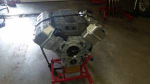

Well just shut the front door....live and in living color....a low deck hemi block....and only $1600....what a deal....wonder why its for sale? I think I'll pass....if I really want a real HEMI, I'll write the big check and buy one...complete, dyno run and ready to go....just my opinion of course.
I know, right? It set records and everything!
If you know, why don't you share your knowledge with the rest of us...."inquiring minds want to know...". What records? Where and when? Define "everything"....horsepower produced, max RPM achieved, dollars spent to achieve results, etc. Why does the pix of the block show after market main bearing caps? Did the original bearing caps fail? Are the bearing caps shown also cross bolted, like the origional? Just curious....

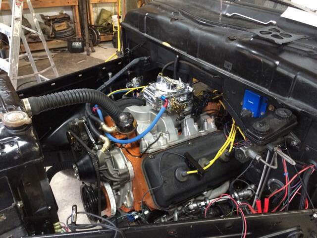

I have a 56 Desoto 330 ci Hemi in my 52 Dodge B3B pickup. I got the Hemi for $250 and then got a quick education on Gen I Hemi's. First off, Pretty much anything before 57-58 does not interchange with anything else; what I mean is that the Desoto Hemi's do not interchange with the Dodge or Chrysler Hemis; same thing between those 2. In 57/58 Chrysler standardized the hemi line. Having said all that, there are some parts commonality between the first Gen hemis and small block Mopars, specifically like the distributor (I am running a SB Electronic ignition on mine). In other words, gen I hemis share more in common with small block Mopars than they do with the big blocks.
You really should check out HAMB.com, also look at what Hotheads.com sells. You are going to find that parts for these motors are not all that easy to come by. No one makes a cam for any of the first gen stuff except the 392; you have to have a core which gets welded up and recut. If you really want to enjoy the car and are not hemi fixated, you are much better off putting in a more modern engine. If you want to stay relatively "old school", then drop a newer 383 or 440 in it; if you don't care all that much about being old school, drop in a 5.7 hemi with modern trans and enjoy it; or go to a junk yard, find a 5.9 (360) and trans and transplant that; you get a roller motor, relatively simple EFI, lots of available parts, serpentine system, etc.

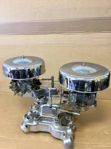

I have a gen 1 hemi 331, bored .30 over, 336. I used a modified 340 oil pump, the usual oil bypass block off plug, spin on adapter. I also have the hot heads single four barrel aluminum intake manifold. I have an isky cam 465 lift lsa 110 degrees, i'll have to look at the cam card for the duration. Arias 10:1 compression pistons, stock forged rods, and crank, severe duty oversize stainless valves, msd ready to run distributor ( i hate the word "dizzy"). I have the flex plate, trans adapter to use a small block 727. And i have motor mounts with 1/4 inch plate welded to the front ears on the mounts to put the motor in the correct position. mid sump oil pain, modded transmission crossmember. I went with the small block chevy water pump adapter. Arp rod bolts, head studs, oil pan studs. Btw the engine brackets/ mounts are 318. Kinda long winded, but i saw your post. There is a guy on YT who stuck a 354 hemi into an A body dart. I used collars on the rocker shafts instead of the springs, they kind of wobble around a bit.
