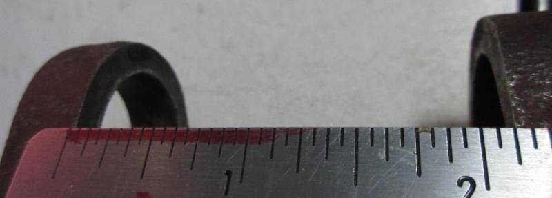

My bearing cap size is close to 1 1/16", which is 1.0625, so that means the 1.078" u-joints should work.

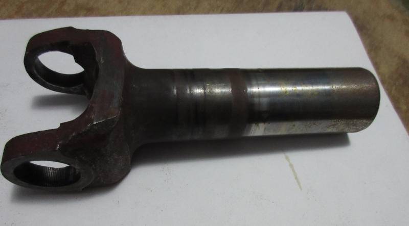

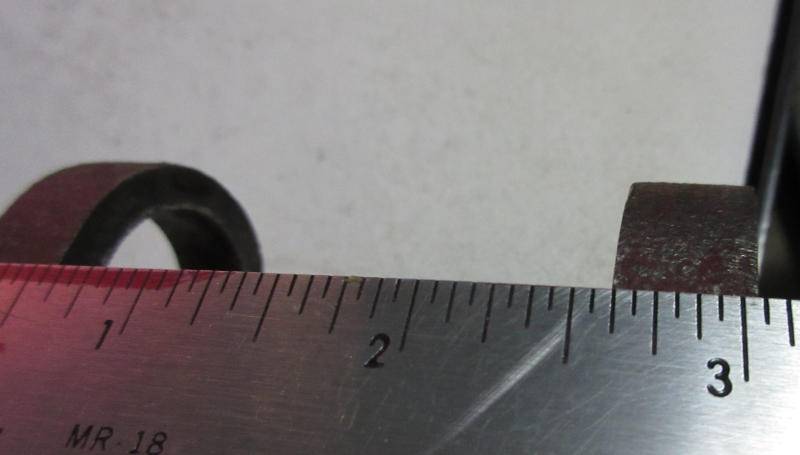

I'm not sure what "outside diameter yoke span" is. I measured my slip yoke -
I've got a 2 1/8" inside diameter, and there are a couple 2 1/8" or 2.125" outside diameter yoke options.
It seems likely the 1 1/8" bearing cap size and 2 5/8" outside diameter yoke u-joints are for more powerful cars than what I've got. The 1.078, 2.125 outside diameter yoke u-joints should be the ones I need?

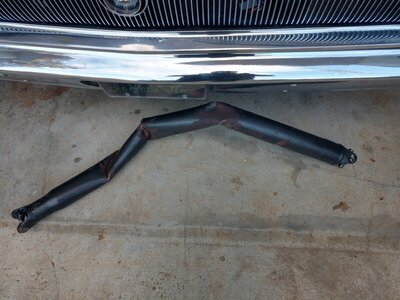

When I twisted the driveshaft out of my Charger
The u-joint clearly fractured along the grease line
This cost me a lot of money in parts
(new driveshaft, new yokes, new differential, new exhaust, new electric cut-outs)
I ultimately upgraded to solid 1350 Joints
O.K., how much power were you making? How did it damage the diff?
Not a lot of power as I was on the dyno preparing for my first run and let go at about 3500 RPM
I suspect the the U-joint was bad even though it was new (less than 500 miles on it)
Both yokes was broke and had to be replaced
The differential was noisy before but much worse after the accident,
I suspect we somehow changed the pinion set when changing the yoke
but rather than mess with it I replaced it with one under warranty

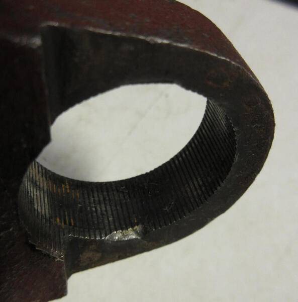

Well that's terrifying. I managed to gouge the edges of my drive shaft yokes when I was cleaning them. Here's the worst one -
I've been told not to worry about it, but now I'm worried about it.
I have a modified 440 with a lot more torque and HP then your 318
I doubt yours will be a problem however piece of mind is worth $100
slip joint yokes are about $100 at Doctor Diff
In the past I would have thought nothing of that
I would have used it
but now that I have been burned I would replace it
