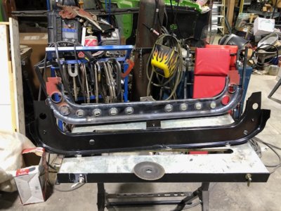

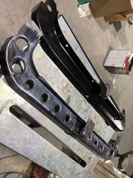

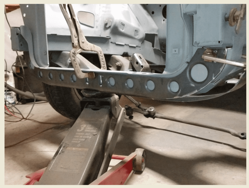

Working on my 69 RoadRunner and was going to replace my lower radiator support with an AMD piece then install a U.S. Car Tool body strengthening piece and realized you had to chop up the new radiator support to install it so I modified the U.S. Car Tool piece instead. Tomorrow I'm going to weld it in then it goes on the rotisserie so I can install the rear spring relocation kit and work on the mini-tubs. Once that's done it goes in to be media blasted. Please let me know what you think. Doing all but the paint myself.

I welded my usct rad support on over the stock one. Someone makes a 1.5" box tube one that really looks like it would stiffen things., I have one of those also, but choose not to put it on, yet. Kinda overkill for my motor hp at present....

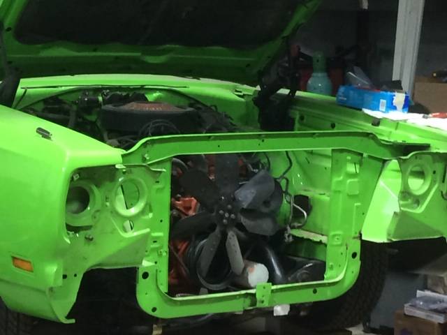

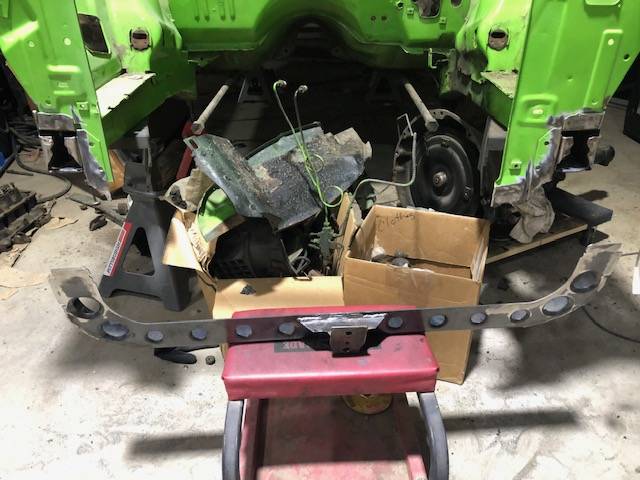

The car is still coming apart. I came down with Parkinson's Disease this spring and only recently was able to get back to working on it. Tomorrow I weld the lower support on then weld up the rotisserie mounts so I can finish up the rear bits for the Reilly rear suspension and mini tubs.

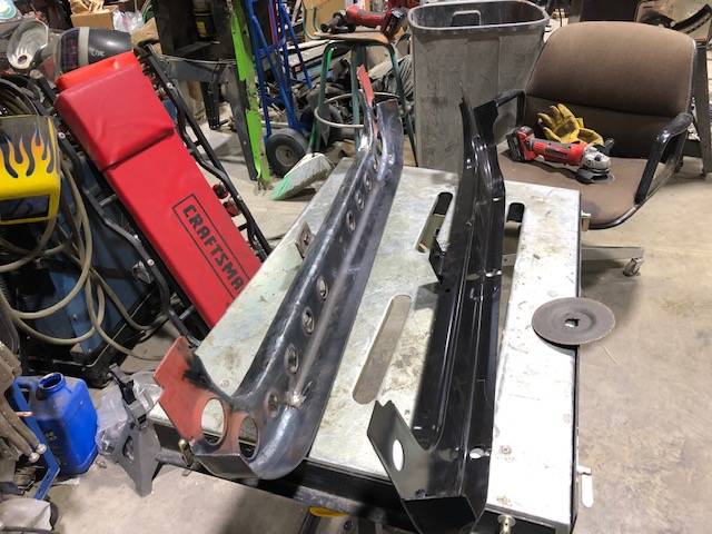

I too welded mine to the original support, but I also drilled out the hole openings because I liked the way it looked . . .

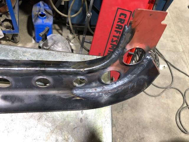

Finally tracked down the picture to share . . . page 22 in my build documents the process . . .
Your build is very similar to mine. If you need tips read through my thread. I did all the US car tool upgrade with some mods.
