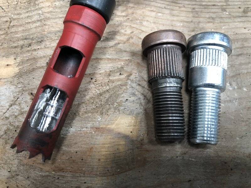

Yes, the original drum brake hub is reused on the kit I ordered. ( scarebird has other kits for more $ that use a new rotor and hub assembly)The center hole of the rotor needs to be opened up a bit so it can fit onto the hub. That’s very clear. My question is about the hub. Does the existing drum brake hub get reused? Are the studs difficult to get out in order to remove the drum? Did you need to purchase new studs? Thank you.

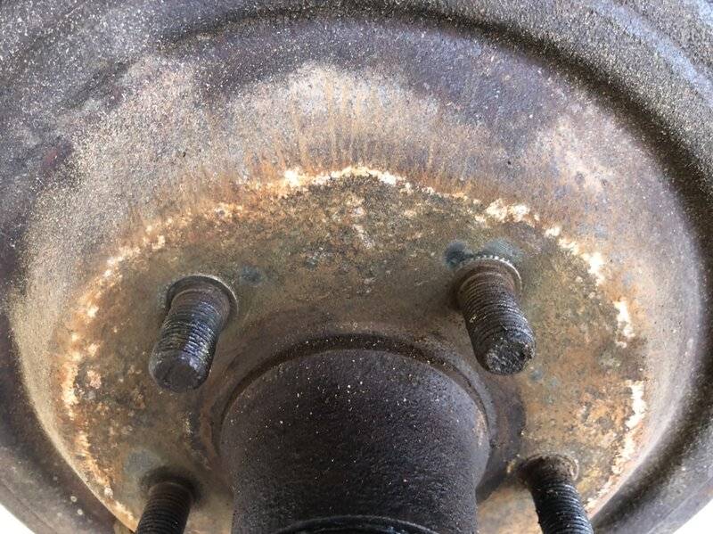

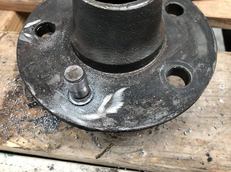

I was able to just remove the swedge stakes and let the drum come off the hub.
My original studs were plenty long for oem style steel wheels.
If a guy was going to a custom wheel with a thick flange you may want to replace the studs with a longer style.
Scarebird on their sight gives a dorman number for a replacement wheel lug/stud that is a little longer.
