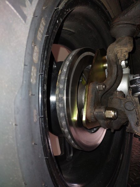

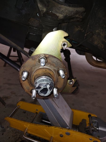

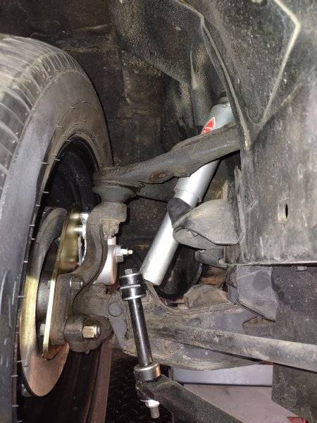

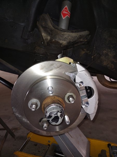

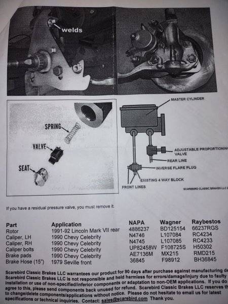

All the B body conversion info. Is also available on scarebirds sight.
Both set ups , one low cost one like I used and the one your thinking of with the Doba rotors.
