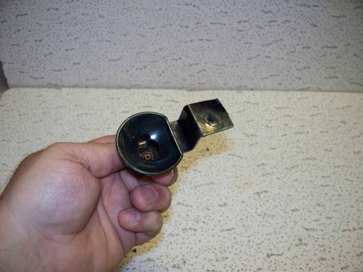

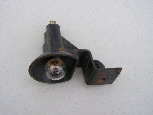

I think 70s A bodies got the map light integrated as courtesy light too down the dash, and this is a plastic housing setup using a regular single contact bulb. Maps lights are also turned on by ground because they light on also with doors
And here is:
vhaEY7WG2hgt1PbE_6xEp44lHWhwRQu47cG4qHmWcMYbKxaeq21LQFaLnypAclwhsaYvWo9d_f3QC6b7_2gZttHyCttwAqi1.jpg
But dunno the kind of bulb they use
