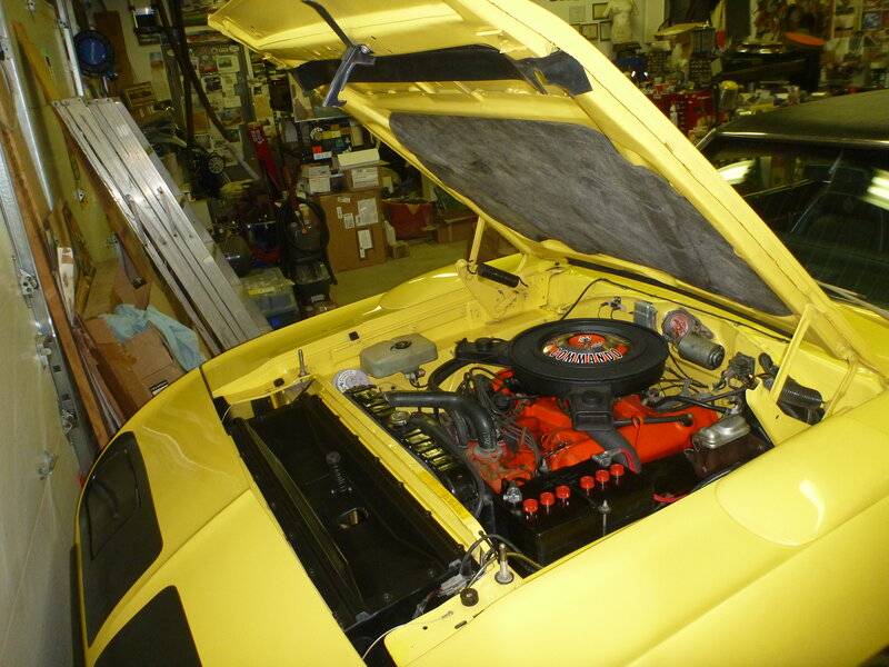

Did all Superbirds have the under hood insulation pad? I see some with the pad and some without. Which is correct? If it was "optional", would it show up on the buildsheet?

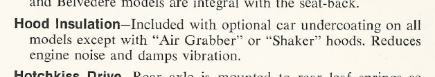

If your car was coded for undercoating, it got the underhood insulation pad. This was an excerpt from the Plymouth dealer book in 1970
Yupper. Code would be J55 on fender tag on 69-71 models.
