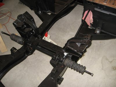

Yes. I did due to the gap between coats. It just hand scuffed it. Pics attached (sorry, not a Mopar, so look away if you have an issue) The coat is a little dusty in the pic, in real life its pretty satin. IMG_1825.jpg
Yes. I did due to the gap between coats. It just hand scuffed it. Pics attached (sorry, not a Mopar, so look away if you have an issue) The coat is a little dusty in the pic, in real life its pretty satin.View attachment 231818

Hell, that's not dusty. I've seen the Eastwood chassis black and it looks good. I wish I had that option.
