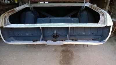

Used lizard skin on my resto several pictures on thread of inside and out

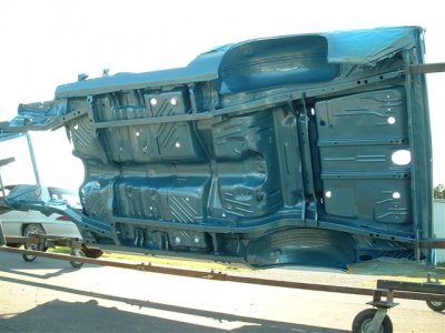

I painted the underside of both my cars the same as the topside. Neither car is a daily driver and does not see rain/snow.

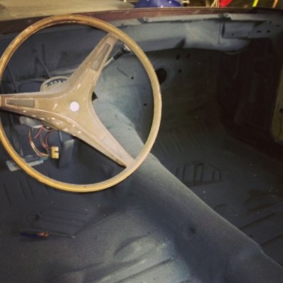

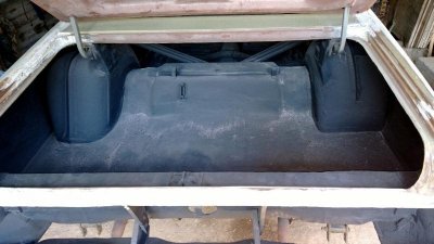

I used the sound & thermal both on the inside. Took 1 gallon each to do inside & out of car. Then top coated with paint.
