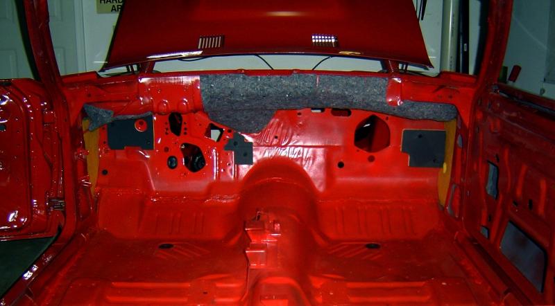

Can anyone assist me? I am about to install the factory underdash insulation on my 71 Charger, and can't figure out where each piece goes! I am also confused about the two pieces of fabric "shoddy pad," where do I glue those down!?
Thanks SO much!
This is my 73 RR, but I think it should look something like this. Note the shoddy pad on the drivers side should go under the support bar if you have one, I took this photo before I corrected.
