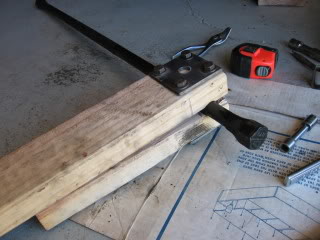

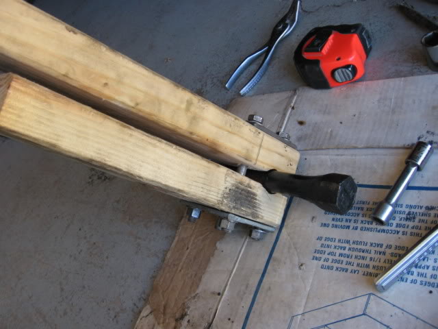

I have heard guys doing it with a couple 2x4's and bolts.
Stole these off another site.
Made a wooden tool like that and it just slipped. Figured out no torsion bar removal tool is needed when removing lower control arms too.
