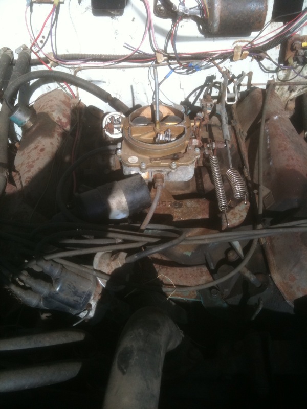

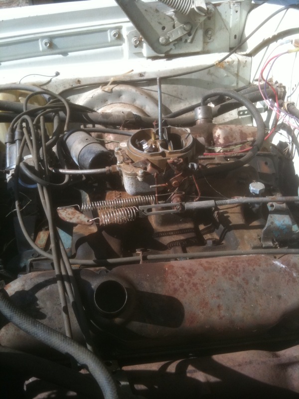

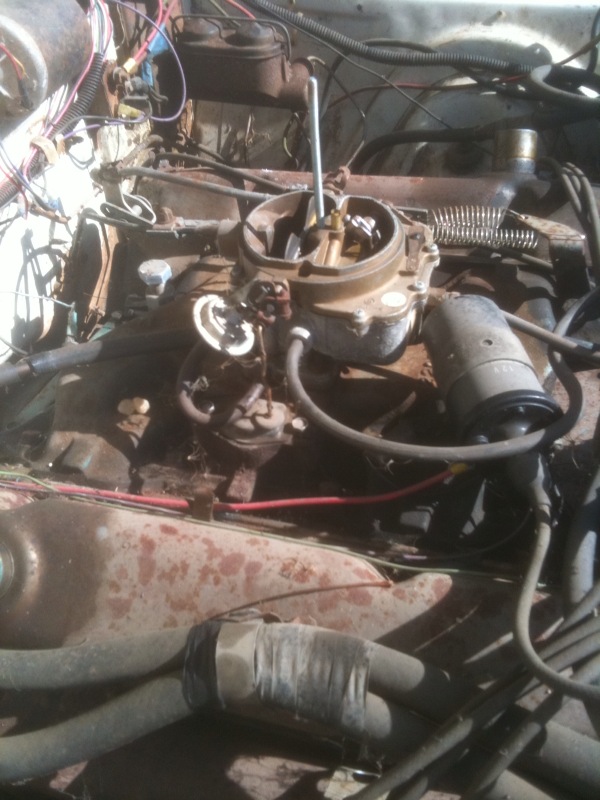

Sorry guy's, I couldn't get my hands on a camera last night. But I do have some pictures of the old 2 barrel carter that I took off last month. The car did it then as well, the linkage setup didn't change when I put on the Holley. except that the throttle linkage is now 1/2 an inch more towards the left. I have check the linkage again last night and we are all good, kick down works great and the throttle cable has no binding. If the car is off I can give it a quick WOT action and the throttle returns very nice and all the way. notice the spring setup on the 2-bbl, I have the same setup for the 4-bbl. Thanks for all the help guys I really appreciate it!!!!

It seems pretty consistant no matter what you try soooo....Is the kickdown linkage binding on something?, Have you tried it with the kickdown disconnected.
I have drove it with the kickdown dis-connected...NOT THE THING TO DO!!! With the 727 the kickdown is very, very important. The pressure of the throttle dictates the shifting point of the trans through the kickdown linkage. If you drive it without the kickdown you will scatter your trans...it just a matter of time. I have checked and re checked the linkage for binding or hang ups and it is on the up and up. I do have an excess amount of drive line travel when I put her in gear(she clunks rather loud.) So my money is on the motor/trans mount, however I have been wrong before.
