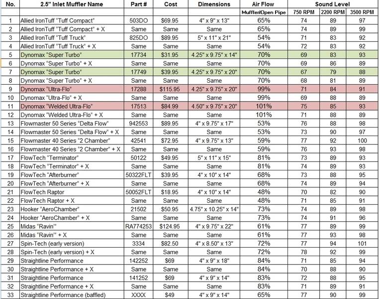

I just put a full TTI h-pipe system and headers on my 360 (smog motor w/edelbrock carb) and it sounds very tame. Tried the super turbos, then switched to Ultra-flows for more bark. It still sounds very mellow. The exhaust note is pleasant, and excellent under full-power acceleration but very tame at idle and low-rpm.

According to this chart the super turbos & the ultra flow are very similar @ Sound levels, Flowmaster 40 series is the only way to Go if you want that rumble, IMO.
