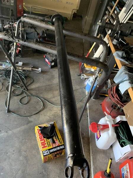

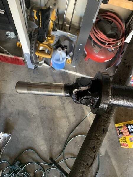

....so.....thinking this going to be a tad more simple than it's turned out to be.....but are the universal joints for a 67 Coronet 8/34 a crap shoot? I pressed out the rear one, and scored a NOS TRW 20059 unit.....but is seems a bit larger than the one that came out. Is this a front unit? Needless to say......I may need an opinion on what I should press back in there....
If it's a large u-joint (3.625") should be a 1330 cup diameter 1.0625".
If you have the 7290 joint and caps, you can replace the 7290 cap with the 1330 cap.
The shaft is not that big

Shaft 2660635 1967-68 2.75 52.00 727 8-3/4 318 383 Belvedere Coronet Charger

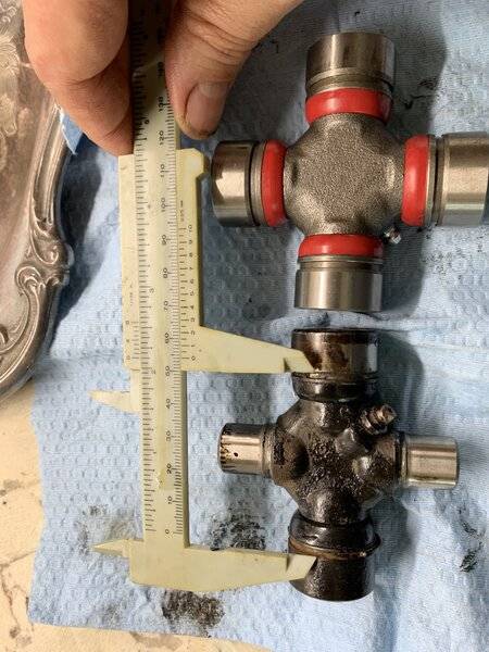

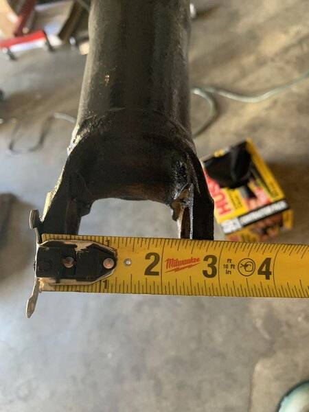

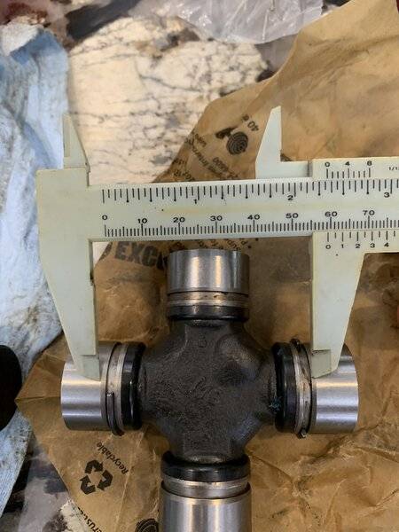

So, I just picked up a few at the local auto store only to find out they are incorrect also. I need a set that’s 50mm between the caps .
Here’s one of the u
MM' what is that in English ?:DCan't calipers in pic's. Did the yoke get tweeked in removing u-joint?
looks like I need a set of
Dana Spicer 5-3228X or 5-789X

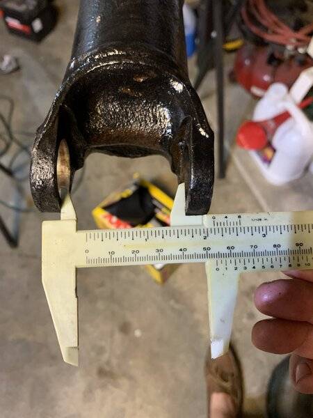

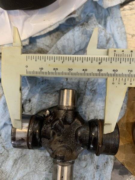

I'm not reading 50 mm on that caliper. It is approximately 54 which is 2 1/8"
....been a long day for Durandal25. He clearly sees that he's been looking way too close to the issue. More beer is required.
I’m really confused
why are the sizes for these u joints still off? This time MOOG 246’s 7620
7A2B5BAB-D21A-4B36-BD5F-ECAF771791F2.jpeg DDC1C067-790A-41DA-838E-36EA0AACF5F7.jpeg
I put new ones up to the yolk and they don’t fit either.....at a total loss
