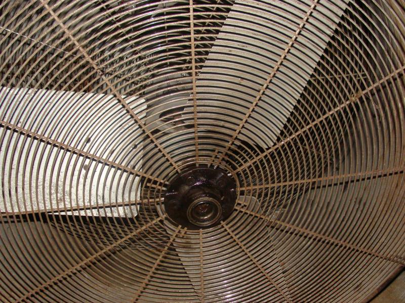

Had a big broken shop fan given to me. Bearing went bad and wore shaft off where it tapered down to 1/2 inch from 3/4. Company dont make replacement bearings and shafts so I was on own. Walked around the garage looking at all my jumk and came up with this, 10 inch drum brake hub uses a 3/4 inch inside diameter bearing. Pressed the bearing on the shaft and bolted the hub to the guard screen. Voila!Shop fan works great. Feels good on the patio on these hot Tx. nights. What odd uses have you found for Mopar parts. 012.jpg

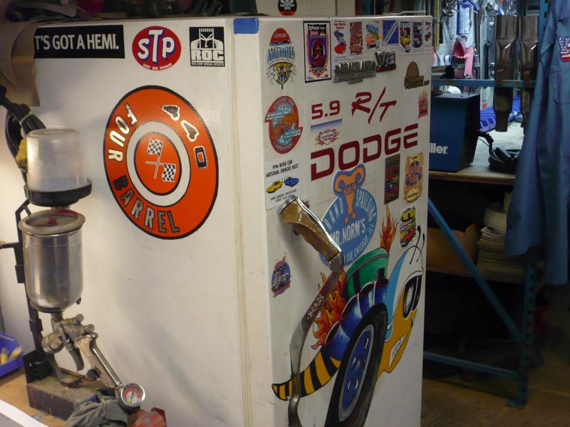

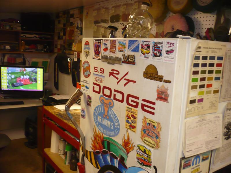

My beer fridge handle fell off one day. After finishing all the beer in the fridge i got a great idea...beer fridge 007.jpgbeer fridge 003.jpg

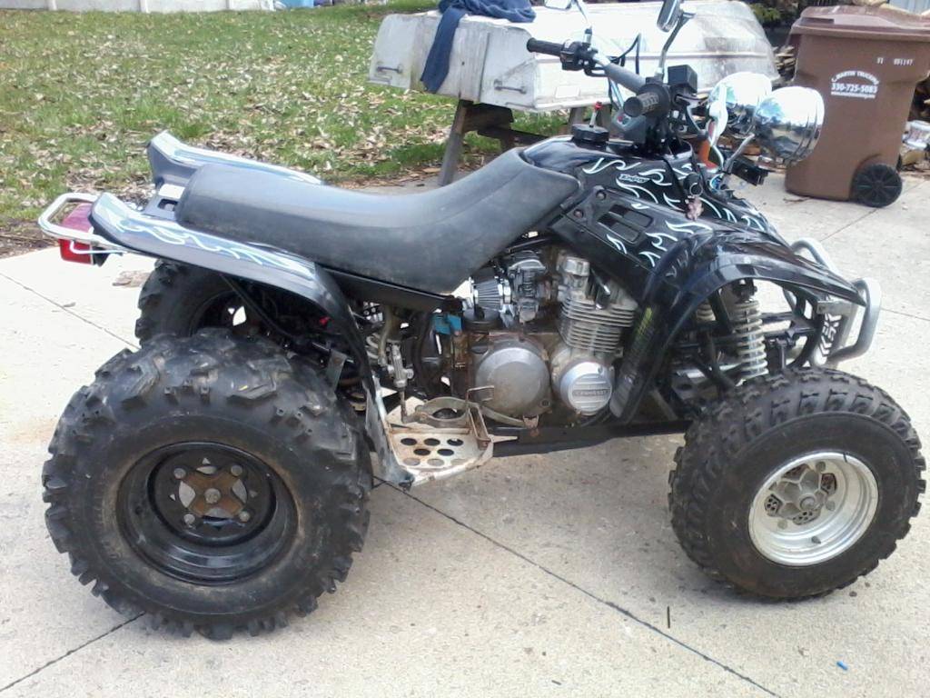

or how about when I re-purposed a kz550 motor I had laying around, cut up and re-welded a Yamaha warrior frame, complete rebuild and stuffed that KZ motor in it, got it up to 80mph and still had 6th gear to go...ahhhhhhhhhhhhh

I bet that 4 wheeler will scoot.

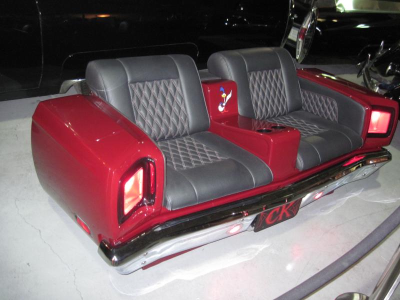

Here's the only Mopar I saw at Count's Kustoms in Las Vegas last week!IMG_1843.jpg
