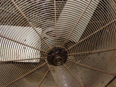

Had a big broken shop fan given to me. Bearing went bad and wore shaft off where it tapered down to 1/2 inch from 3/4. Company dont make replacement bearings and shafts so I was on own. Walked around the garage looking at all my jumk and came up with this, 10 inch drum brake hub uses a 3/4 inch inside diameter bearing. Pressed the bearing on the shaft and bolted the hub to the guard screen. Voila!Shop fan works great. Feels good on the patio on these hot Tx. nights. What odd uses have you found for Mopar parts. 012.jpg
