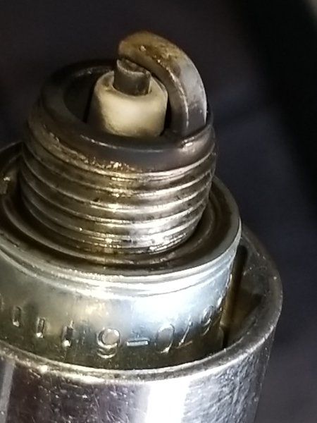

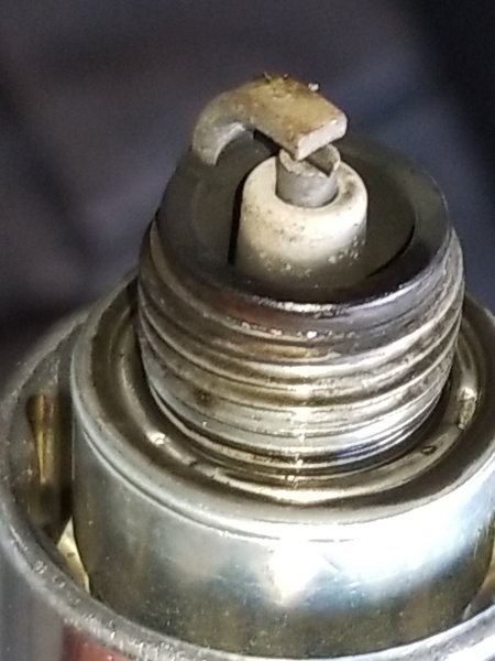

You need to read your plugs
this is a great explanation of what your engine actually wants,
as in timing & fuel
'NGK' plugs are the easiest to read, not required though
good luck
IT'S REALLY HARD, to tune over the -www- or in print
as in timing & fuel
good luck
At cruise i have 16 inches of vacuum. Accelerator pump is adjusted correctly. I have a .031 squirter in both primary and secondary side.
