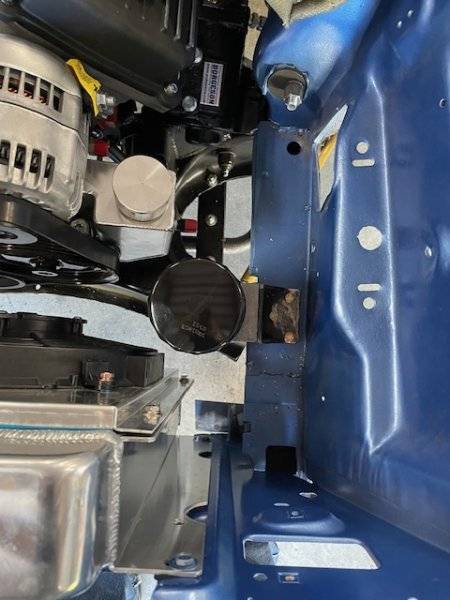

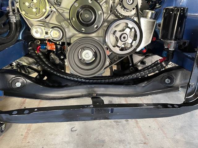

If you have it available and it’s not too much trouble could you post a pic of the set up you have for the remote location of the oil filter and the parts needed for it.
I used
Earl's HEMI0003ERL Earl's Oil Filter Relocation Kit - Mopar Gen III Hemi - Fits M22 x 1.5 Filters
I have the RMS front suspension, but a 45° adapter clears everything. I have just enough room to get the filter out. Might be worth mocking up before deciding which way to go.
