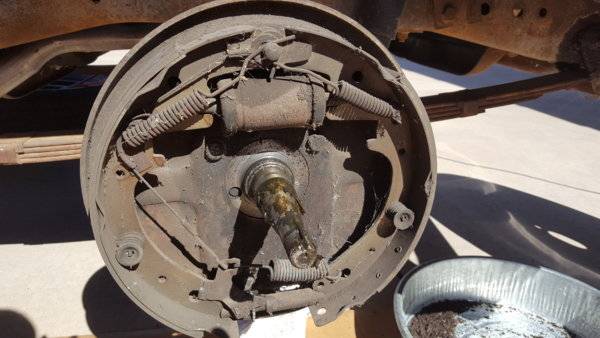

Actually yes! After getting the truck running and driving, I noted that it was overheating and pulling hard to the right on braking. I drained and pulled the radiator and found it full of grit and what looks like small gravel. I have taken the radiator to the shop for a good rodding out. I plan to flush the block this Sunday. As for the pulling issue, I pulled the front drums and found them badly worn, lots of ridges, and the bearings had very little grease. I ordered all the parts for new front brakes, and this afternoon, I am going to drop off the new and old drums so the hubs can be pressed from the old drums and in to the new drums. I will also replace the old left and right hand studs with all new right hand studs. Once I have the new drums back with the hubs and studs pressed in, and the clean radiator back, I will finish the brakes and radiator installation. I will fire up the truck and do another test drive and see what needs to be addressed next!

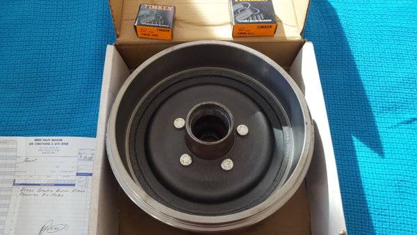

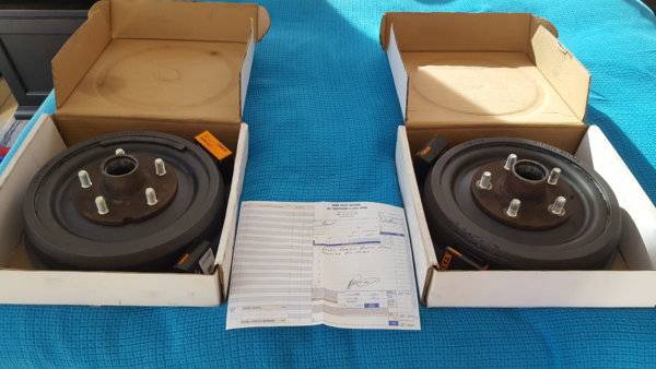

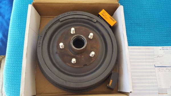

Ok Bill, I got the drums and hubs back and they look great. He pressed out the old hubs and studs from the old drums and pressed in the old hubs and the new studs in to the new drums and he even pressed the new bearing races in both hubs for me for only $75. I think it is a bargain. I mentioned that I might be sending another guy needing the same thing and he just said that he may need a week to get it done. Here are some pics.
View attachment 577770 View attachment 577771 View attachment 577772 View attachment 577773
