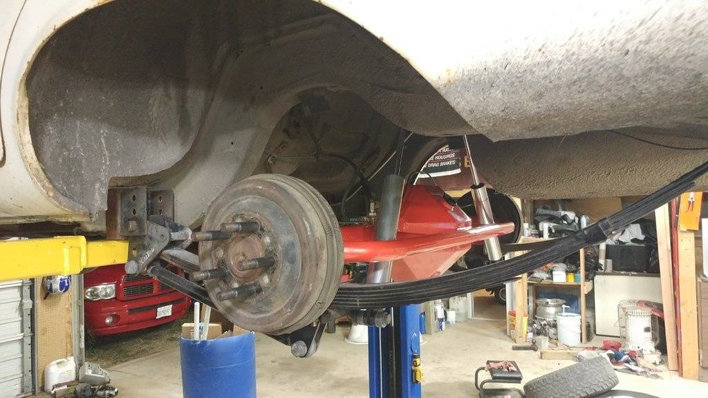

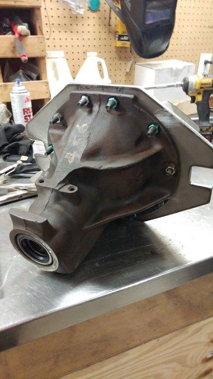

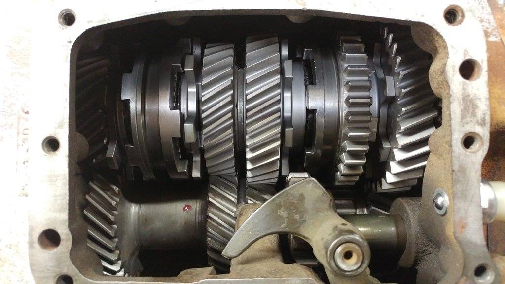

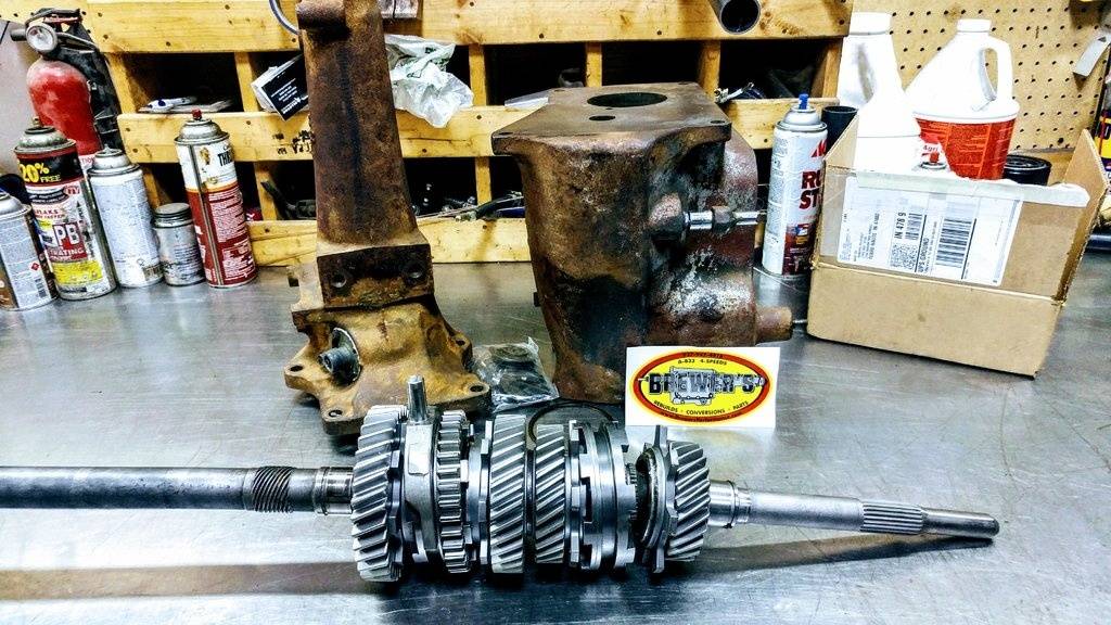

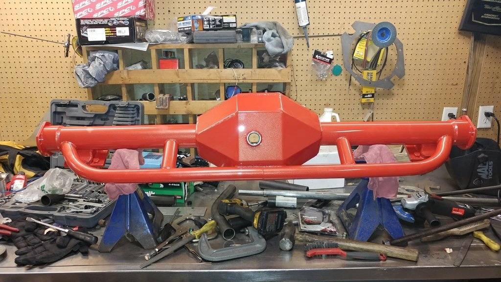

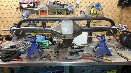

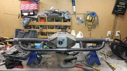

I have been beating on this combo all summer and it is finally coming around to what i think its potential is. Had a few set backs along the way it was twisting the 8 3/4 housing(gaining 5* pinion angle every race) so i built a custom one for it myself as i want to be able to swap gears easily in it so i didn't go to a Dana 60 once that was done I also finally put together and installed my liberty faceplated a833 transmission from the stock a833 that was in the car and im finally seeing good results. This past weekend testing here are the pics and a video of it driving around a Camaro on the big end lol the guys face in the Camaro was priceless watching that wagon fly by

I don't have the motor in yet, still a few weeks out then I need to break in the new s60 rearend 500 miles. But as sooon as I can I'll be out there
