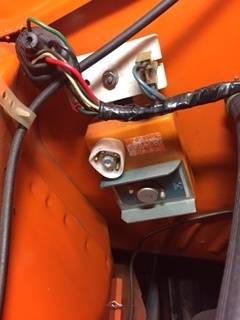

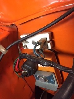

I have a 69 Roadrunner 383 that I would like to update the engine wiring harness and electronic ignition module. Can someone help with the correct wiring harness from year one, is it HU197BM? Also, is there an updated Electronic Ignition Module that will work with this, without replacing the electronic ignition distributor? Here's what's in the car now, thanks.

Usually the original Mopar dist system for electronic ign works with ANY elect ign system. All elect systems works basically the same, being a magnetic trigger for any ECU system, from stock up to Multispark systems
You biggest problem is getting a Chrysler style ECU that isn't junk.
You won't find one at your auto parts store.

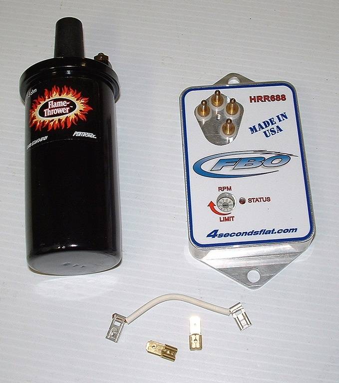

I went the FBO unit because
1. It is a well made product and works good
2. I wanted 4 pin plug and play.
3. I'm supporting "the hobby" sort of.
I am very pleased with it.
I am running it on my daily driver.
Over 70 miles a day.
I don't like "failures" in traffic.
I will probably get around to putting it on all my cars.
It will work good with your stock distributor.
No worries.
http://www.ebay.com/itm/221759869530?_trksid=p2057872.m2749.l2649&ssPageName=STRK:MEBIDX:IT
http://www.4secondsflat.com/Ignition.html
