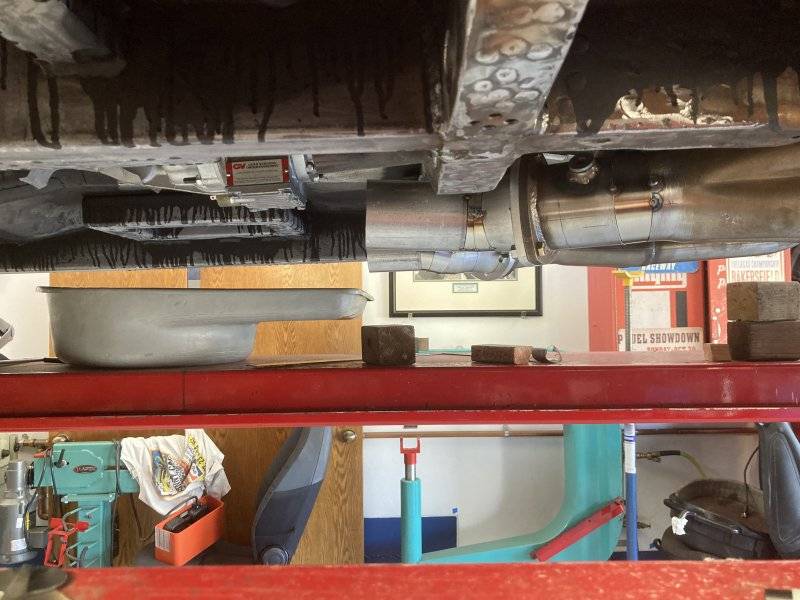

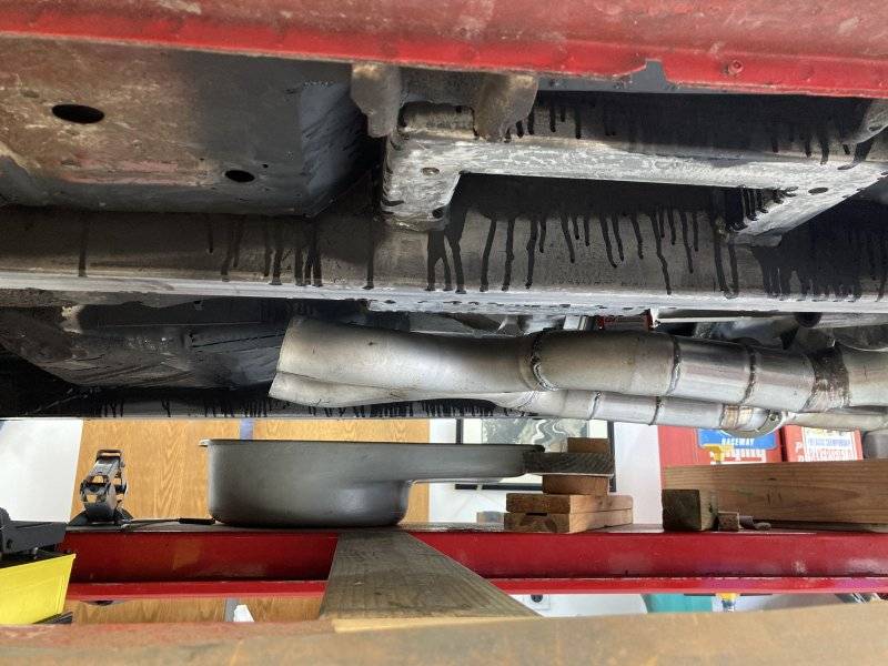

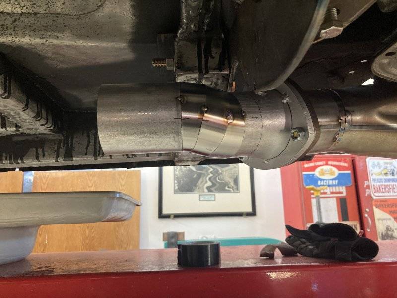

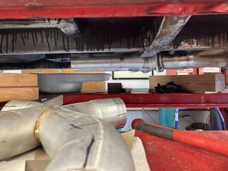

While I'm waiting for the 3" pie cuts, I trimmed down one of the straight reducers in preparation then removed the mufflers from the pipes. Lighten up the load some while I work at fitting pieces up.

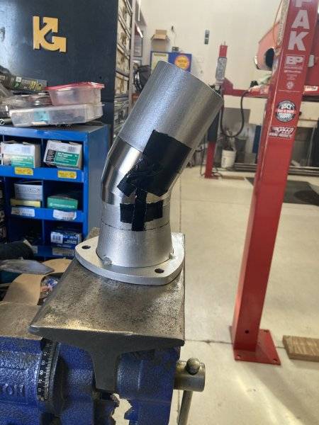

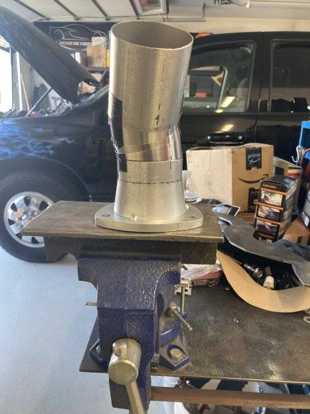

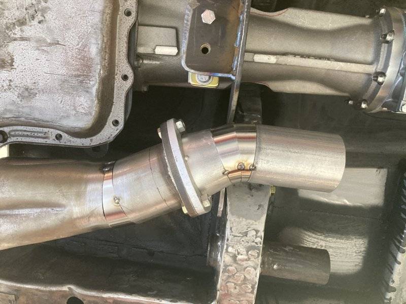

The 3" pie cuts came in today. Came up the a good combination on the lh reducer. Used some duct tape to help hold the pieces together then tacked it together. Went to the rh side and it looks like I need to cut the collector and put at least one pie cut in to get the ball started on that side.
Today I got the rh side squared away. Cut the collector, put in one pie piece, checked the fit with the cut down reducer. Good to go so I marked it, then got it tacked up. Put the trimmed reducer on, used two pie cuts along with the piece trimmed off of the reducer, checked/clocked pie's for best combo, marked then tacked together. Put the mid pipes unit in the general area. Next go around will be to figure out what's needed there.

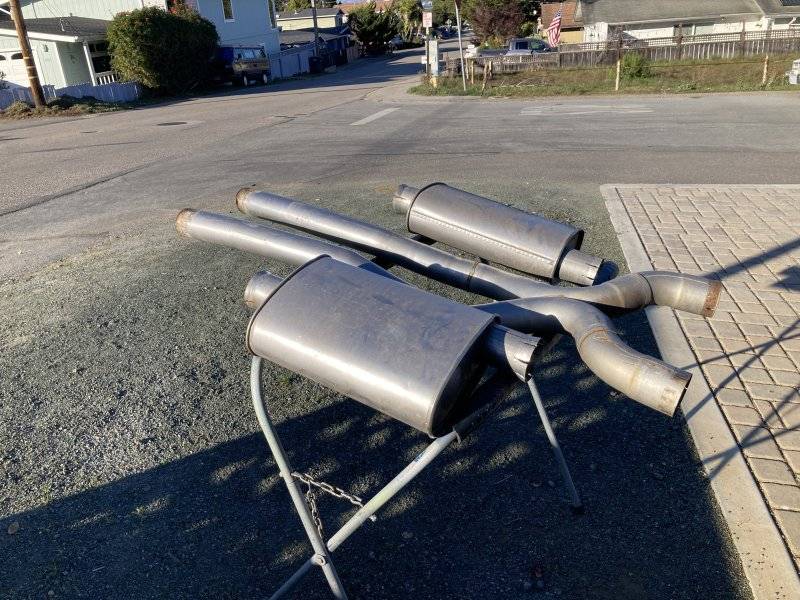

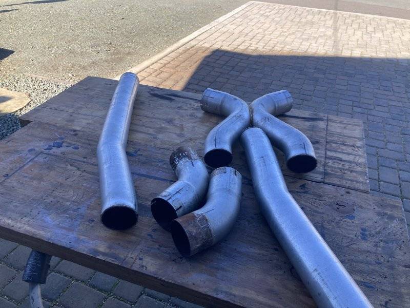

Cut the straight front part if the X. Easy peasy. I do quite a few custom X pipes since the EPA overstepped and closed down a few exhaust manufacturers

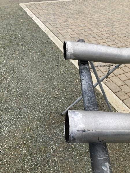

I'll be dissecting it in a few areas from my initial views. Need to ponder what/where/how on the next go around. Today I went ahead and welded up the reducers.

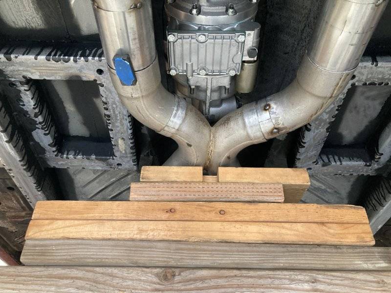

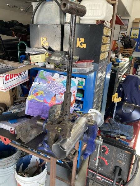

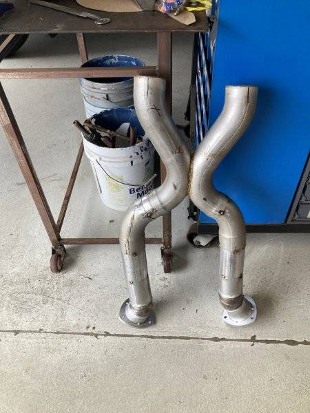

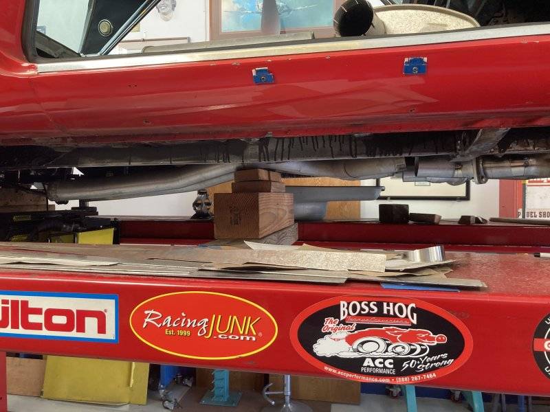

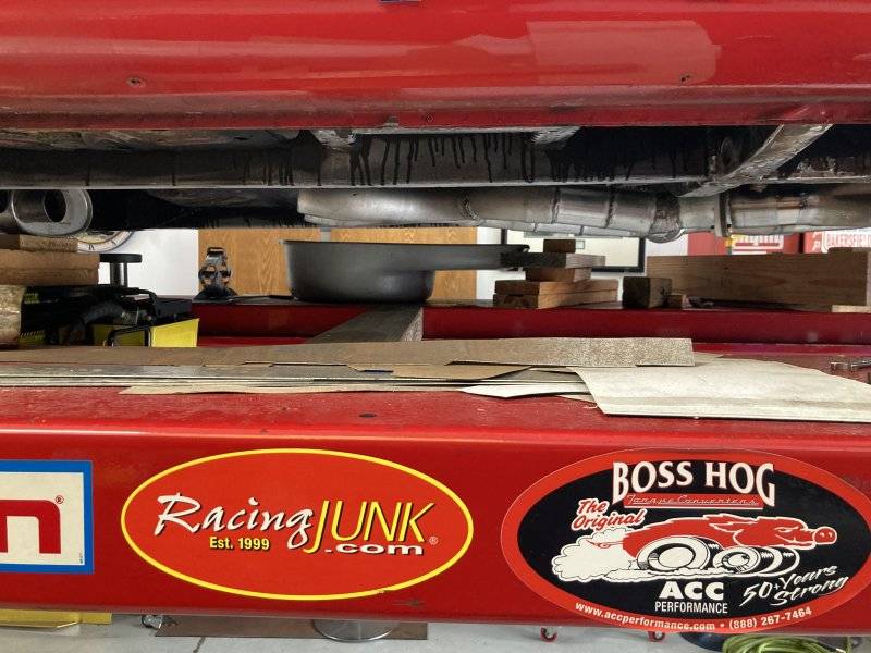

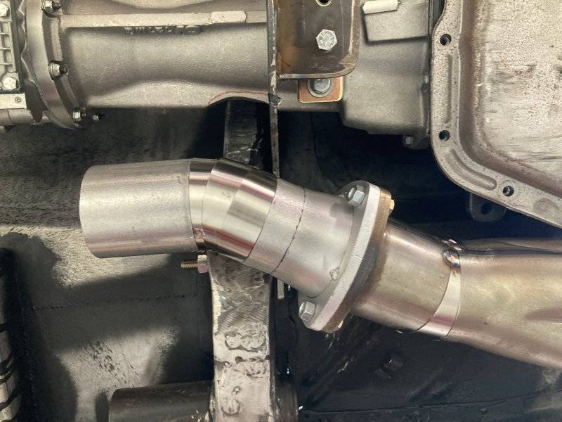

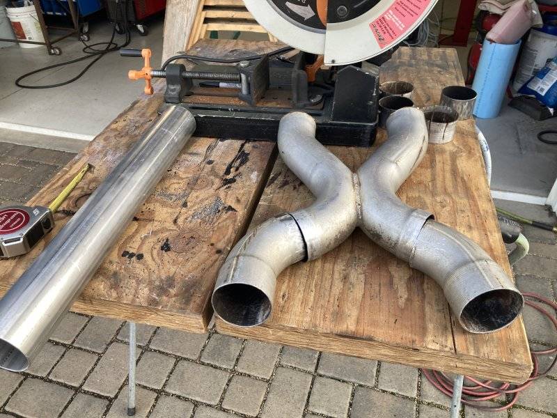

I pondered my puzzle some more today and decided my best route was to cut the unit into a few pieces. I'm going to see if I can find a short piece of 3" tomorrow when I run some errands to move the X back so it's not right under the GV unit. From there, so what/who has to be changed to get it back to the mufflers.

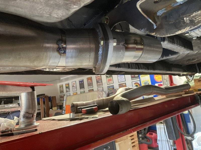

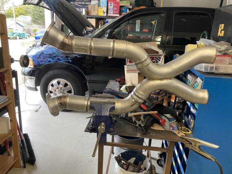

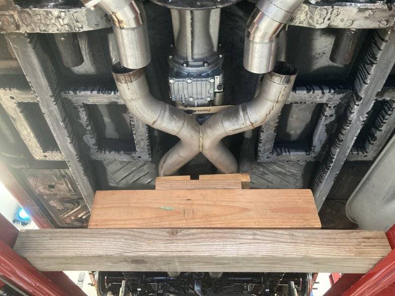

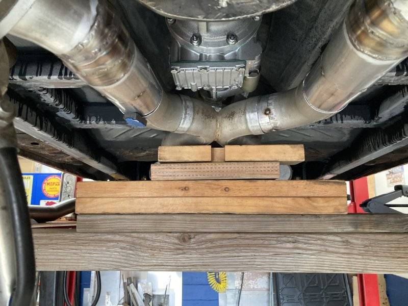

On my errand run, I stopped by a muffler shop and scored a couple of 3" remnants for $5. After I took care of some other house stuff, I worked on the exhaust some more. Put a couple of extensions on the reducers so I can get the X in place behind the GV unit and keep it somewhat cool. I trimmed the X some plus the two 45's that were in it to get closer to the width I need. More soon.

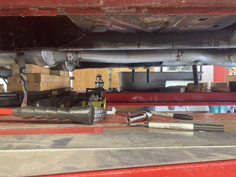

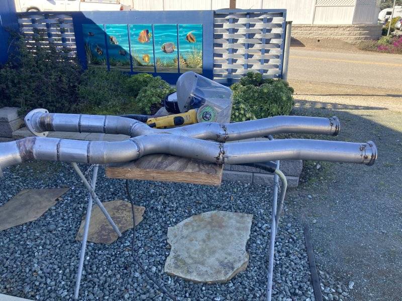

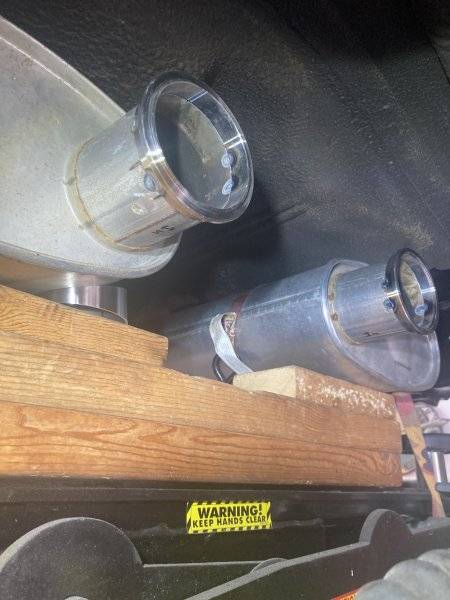

Over the last few days I've been plugging away on the X pipe positioning. Got it squared away today. The remnants I picked up have helped out giving me needed material. I finally had a chance to use the pipe cutter I picked up a few years ago at the March Meets. Great score, cost me $5.00. The meet usually has a swap area and there's a few guys selling used tools. Anyway...once I had the right combo fitted up today and checked for room to the side of the GV unit plus make sure the driveshaft has room, I tacked the pieces together. Pulled the unit off after the tacks then fully welded it up. Where I cut the two pipes on their welds after the X, I knocked those welds down in preparation for the refit. I ordered up a set, of 4, V-Band clamps w/weld flanges. I'll weld these to the inlet and outlet of the mufflers. These will ease up assembly of the tail pipes plus make service of components easier down the road. Regular muffler clamps pinch the pipe down too much even though thats their function. Makes it a pain to get back apart without cutting.

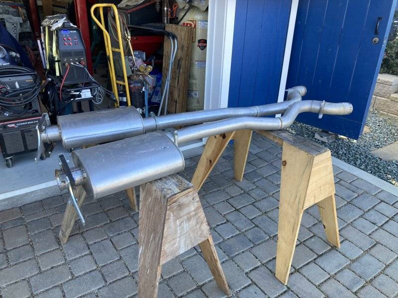

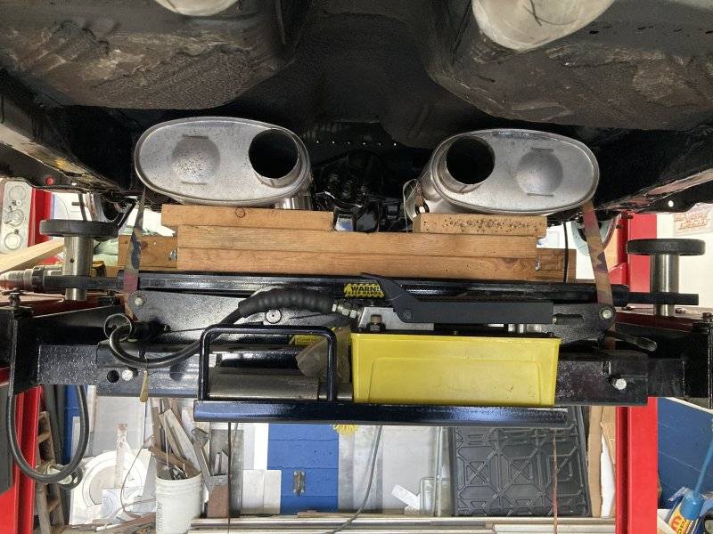

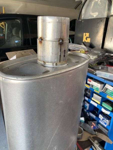

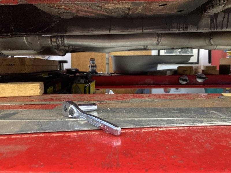

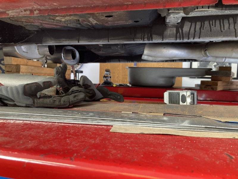

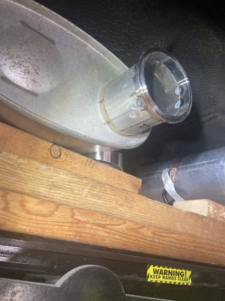

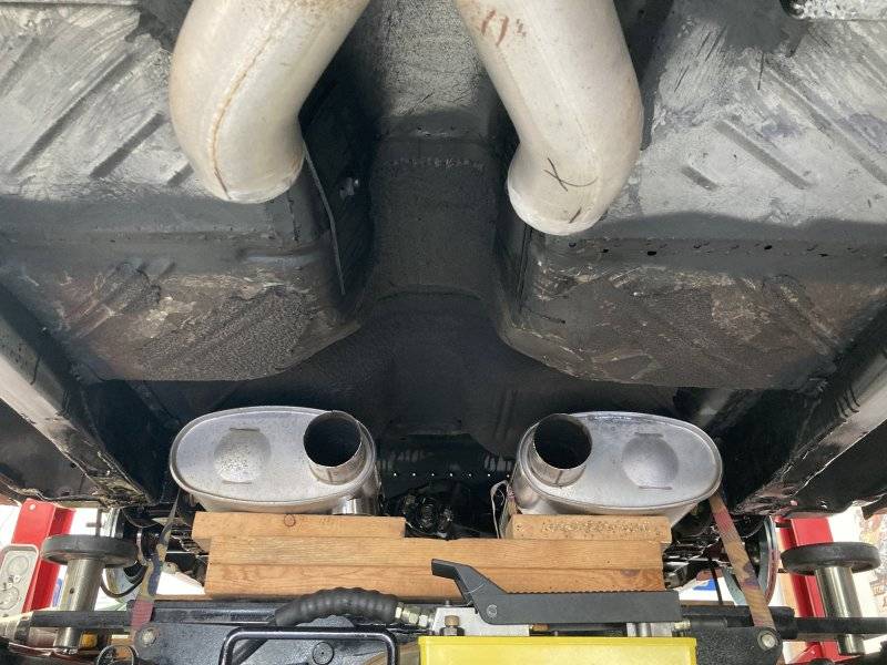

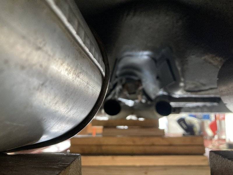

Today I spent some time getting the mufflers situated before putting the pipes in. I ended up putting extension pieces on the outlets so I could move the mufflers forward and give room around the sway bar in the back and more driveshaft clearance in between the units. Swapped places with the TTI hangers since they have offsets which helped too. After getting clearances set and matched with the two sides, I strapped the mufflers down so there will be no movement when I go to fit the pipes in the inlets.

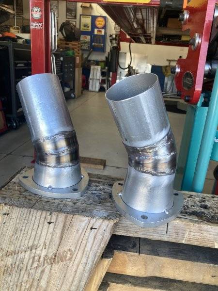

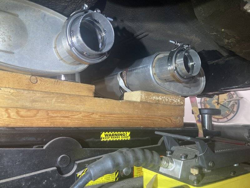

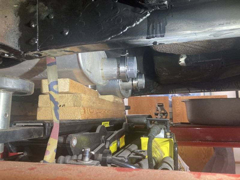

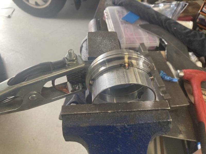

Today I tacked the stubs together then tacked the mate flanges to the mufflers. Keep fitting pipes tomorrow. Going to Santa Maria on Thursday so I'll hit my new supply place. I need more stainless filler rod to complete the welding of stainless to mild steel. I had some 319L stuff but found I can use 309L which is available readily.
After some trimming, filing, bumping, the rh pipe is tacked in. Get on the left one soon. My honey has been clearing out old files in our office. Probably the total stack of paper to get burned is around 10' high. Lots and lots of old files, paperwork, taxes etc. In the pile I found the receipt from Mazzolini for the headers and exhaust, TTI, I bought from Bob in 08. The headers, coated in and out 2", were $700. The exhaust was $650 or so. Current price on that 3" system is $1k. Along with not having many hours on that system driving, the price is a huge factor in my re-using what I have as much as possible.

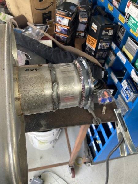

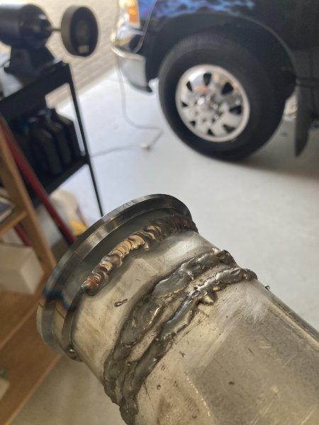

Today I finished fitting up the lh pipe to the muffler. Once the pieces were all tacked. I pulled the mid assembly and the mufflers out, then proceeded to weld. Hit the mid unit first and got all of the MIG welds done. After that, it was TIG time. Welded the v-band flanges to the pipes and then the mufflers. Going to wait on knocking the MIG welds down with the grinder till I get the rest of the system done.

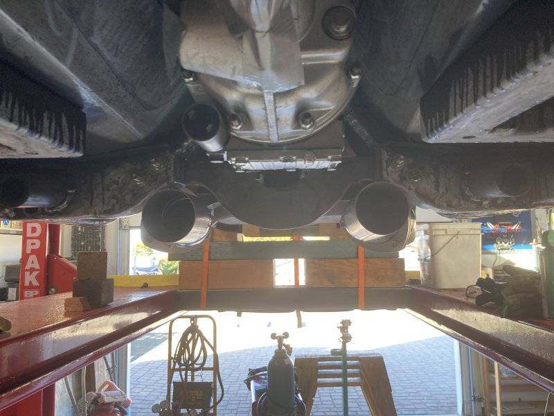

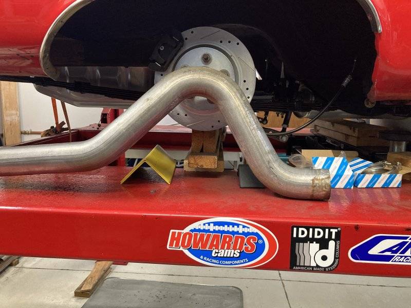

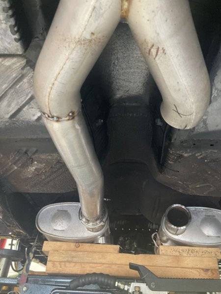

Today I put the mid pipe unit in place along with the mufflers. Next on the agenda is getting the tailpipes to the back while working around modified areas. I pulled out a catalog of pipe bends and was thinking getting one 180* and maybe a couple of 90's to get out, up, over and through. Then I decided to pull out one of my tailpipes to see how it would it might work since it's handy. Looks like it will work for part of the out, up and over. It's about a 110* bend so I cut it before it would drop by the tank and marked where I need to cut for fitting to the muffler with the v-band flange/clamp. More tomorrow.
