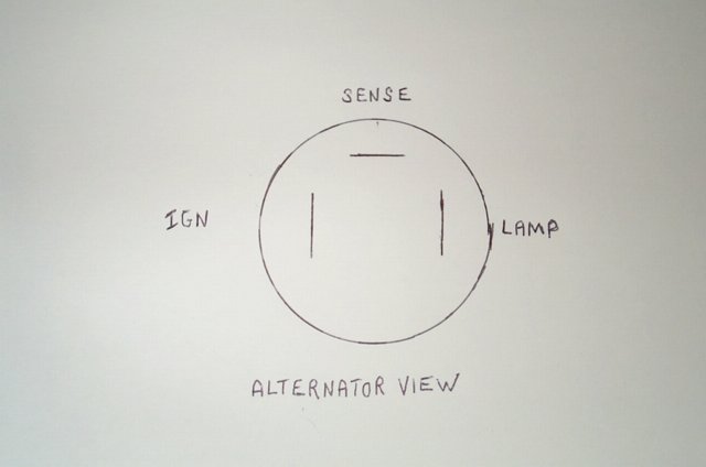

Plumcrazy...any chance you could draw up a simple diagram of your hook-up ? Thanks .
If you use the alternator from Mancini this is what the electrical connector will look like.
I connected the sense wire to the large terminal at the starter relay. It's what the internal regulator uses to sense system voltage.
The ignition terminal get connected to the J2 circuit. If it's a 70 or newer just use the blue field wire. On a 69 or older you need to run a wire to where you want to tie into the J2 circuit.
I didn't use the lamp terminal. I think it provides a ground for the charge warning light if you have one.
