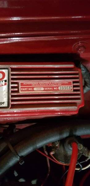

I want to change out the single point distributor on my 66 383 Coronet. Currently the car is set up with a MSD 6400 series box and stock single point vacuum advance distributor. Looking for a good electronic ignition/distributor that will work well up to 6000+- rpm. Car is used mostly on street. Thanks for all the past help with my car. I learn a lot here about these old Mopars.
