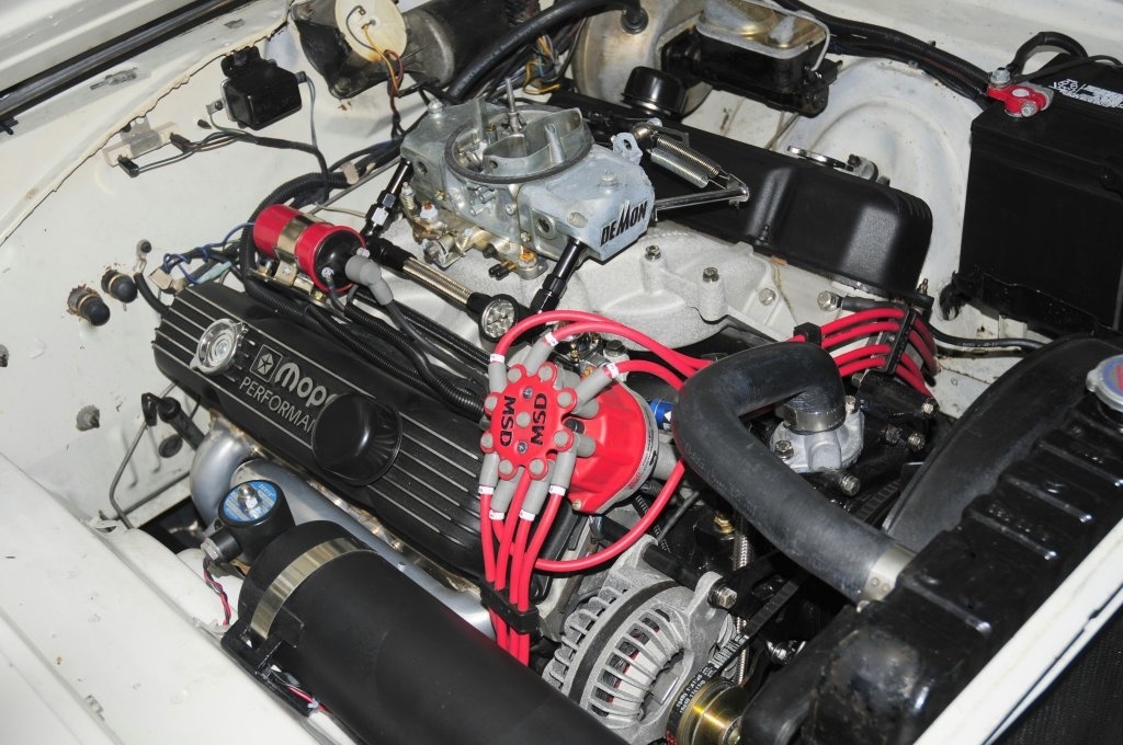

AR Engineering has one that allows you to mount them vertically Here is mine, you can get them at Mancini or Summit
