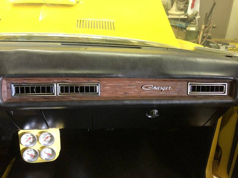

For my 73 charger, i ordered Vintage air part number 49057-vul and they fit like a charm.
Something doesn't look right about those.
Do the OEM's have a box around the outside?
I wish. I need to do mine.
No, but these are not OEM. They are Vintage Air and look pretty clean. WYSIWYG
I handn't looked at this thread for a few days and just got the exact same Vintage Air vents today. Like you said, they fit like a cham-they plug in with no modifications other than pulling the pins the OE vents pivot on
. They arnt exactly the same as the OE vents, but its the next best thing, cheap, and way better looking and working than the warped and salvaged ones I have.
