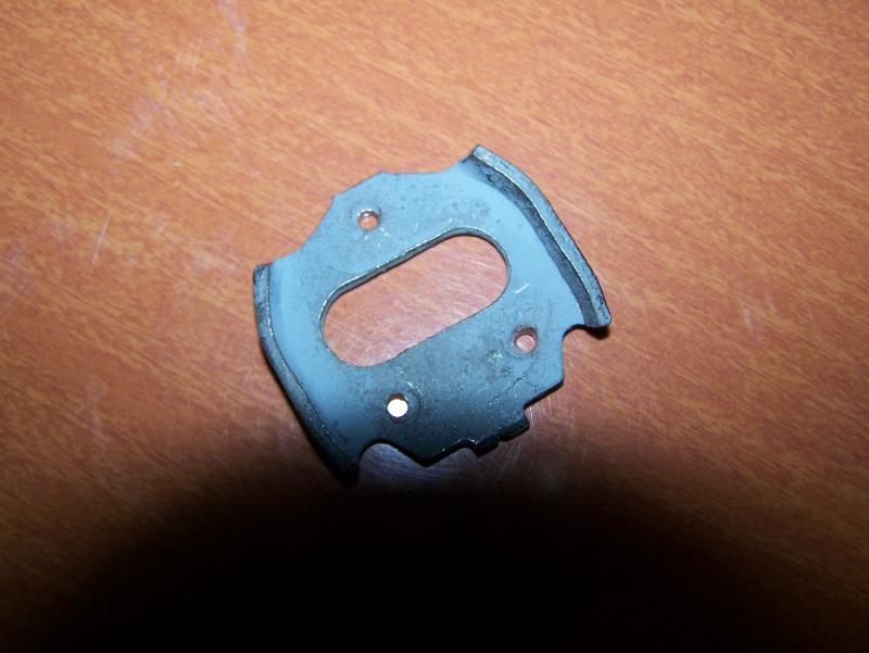

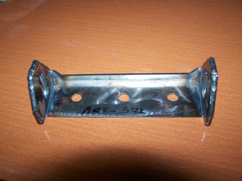

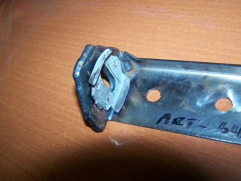

Hi
I own a 69 Roadrunner, due to rust i have had to replace my upper control arm mounting bracket on the left hand side, on this bracket there is the camber adjustment plate. Due to rust i am not able to salvage the two plates from the left hand side, does anyone know what the parts proper name is and where i can get it? I Recently bought a upper control arm mounting bracket to replace the dead one however it did not have the plates i require on it like i though.
I have uploaded a picture of the part i bought.
The part i require.
Where the part goes.
Any help would great.

looks to me like you have all you need there. just have to weld the two together. just make sure the cam bolt eccentrics fit in that cradle without binding and the slots line up

Are you after the bracket that holds the cam eccentrics or the cam eccentrics? the Bracket IS available. That was a new bracket in the photo, the cam eccentrics are NOT available unless you buy a shock tower assembly *check it has them first though. i had to modify that bracket as it was junk but better then nothing and it is solid
