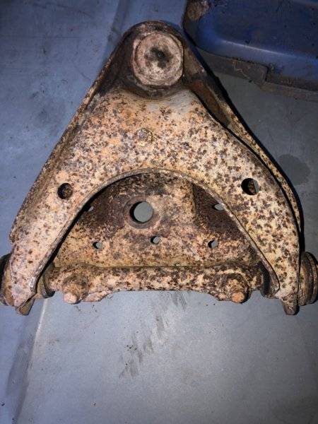

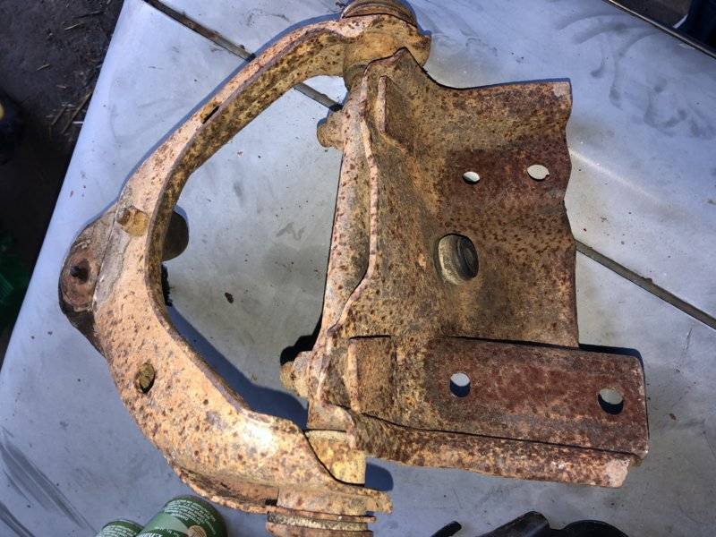

Tell ya what, I’ll save you the trouble, I have a set of 73 B body uppers, they will need cleaned up but appear to be useable. Yours free, just pay shipping.
FB4E633A-1B61-4F7F-94BE-7F3DC640A954.jpeg 42D59FB8-B60E-419A-8C6C-81C9E920F780.jpeg
The answer to the original question is
N O.

Meh, they were quite literally going in the scrap pile if not, so I'd rather someone try and get some use out of them vs them turned into chinese tin cans.
