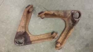

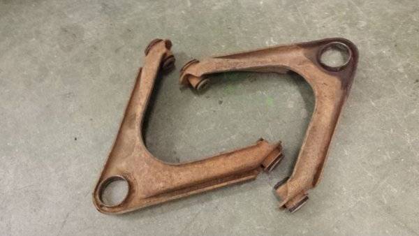

If your interested PM me your zip for a shipping quote and I'll get a pic.

Here is some. They just have surface rust that will clean up good. The metal is still smooth with no pitting.
Ball joint area is clean. Joints came out real nice.
