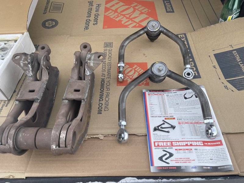

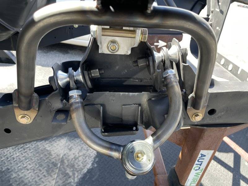

Here’s some Suggestions…..
“ New & Improved “….
Mopar2ya!
