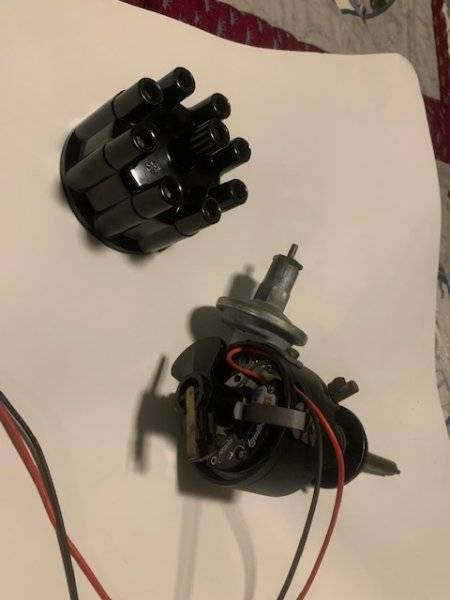

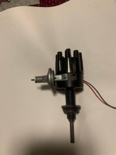

I picked up a RB Prestolite a few months ago, crusty old core $100... Once I cleaned it up it looks pretty decent.. I spent more on the Petronix than the rest of the distributor... But I feel it's worth it... And the wires aren't finalized, I just threw it together for a few photos..
