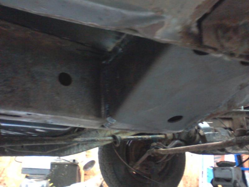

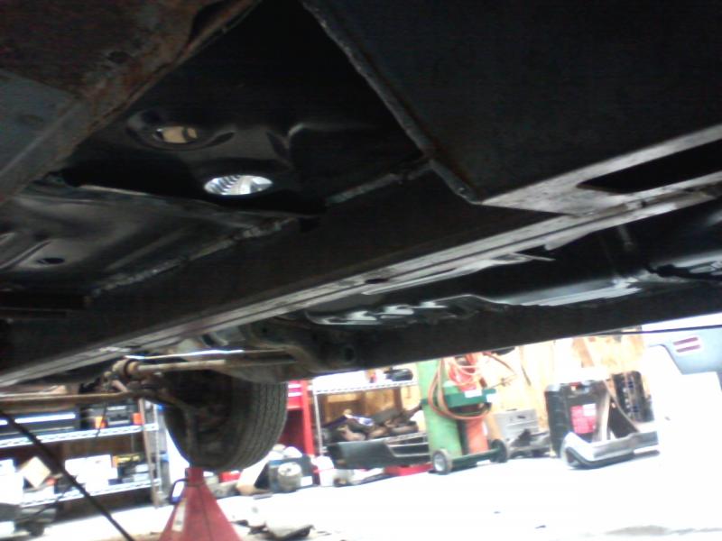

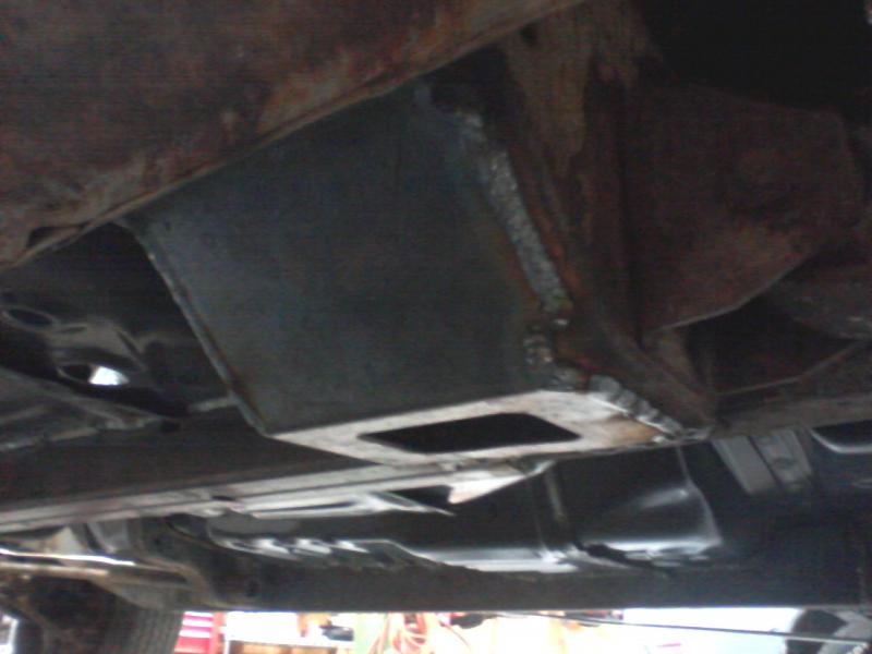

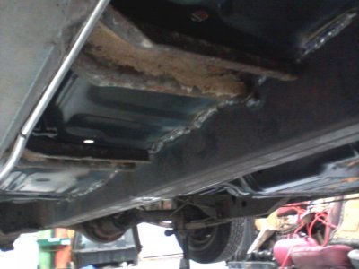

Yes, I installed their connectors and torque boxes on my 66' Satellite. I used ramps in the front and 3 ton stands under the rearend housing. You will need all the room you can get without obstacles to fit and weld in. passenger sub frame connector.jpgpassenger front torque box.jpgDriver sub connector.jpgDriver rear box.jpg

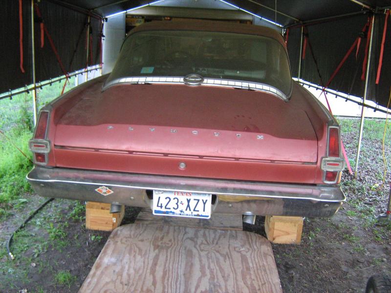

03-24-2012 tailpipes installed.jpgInstalled on 66 Barracuda and not yet installed on 65 Coronet. Used wooden boxes under wheels for height. 2x8 with solid top and center support and handle. picture
